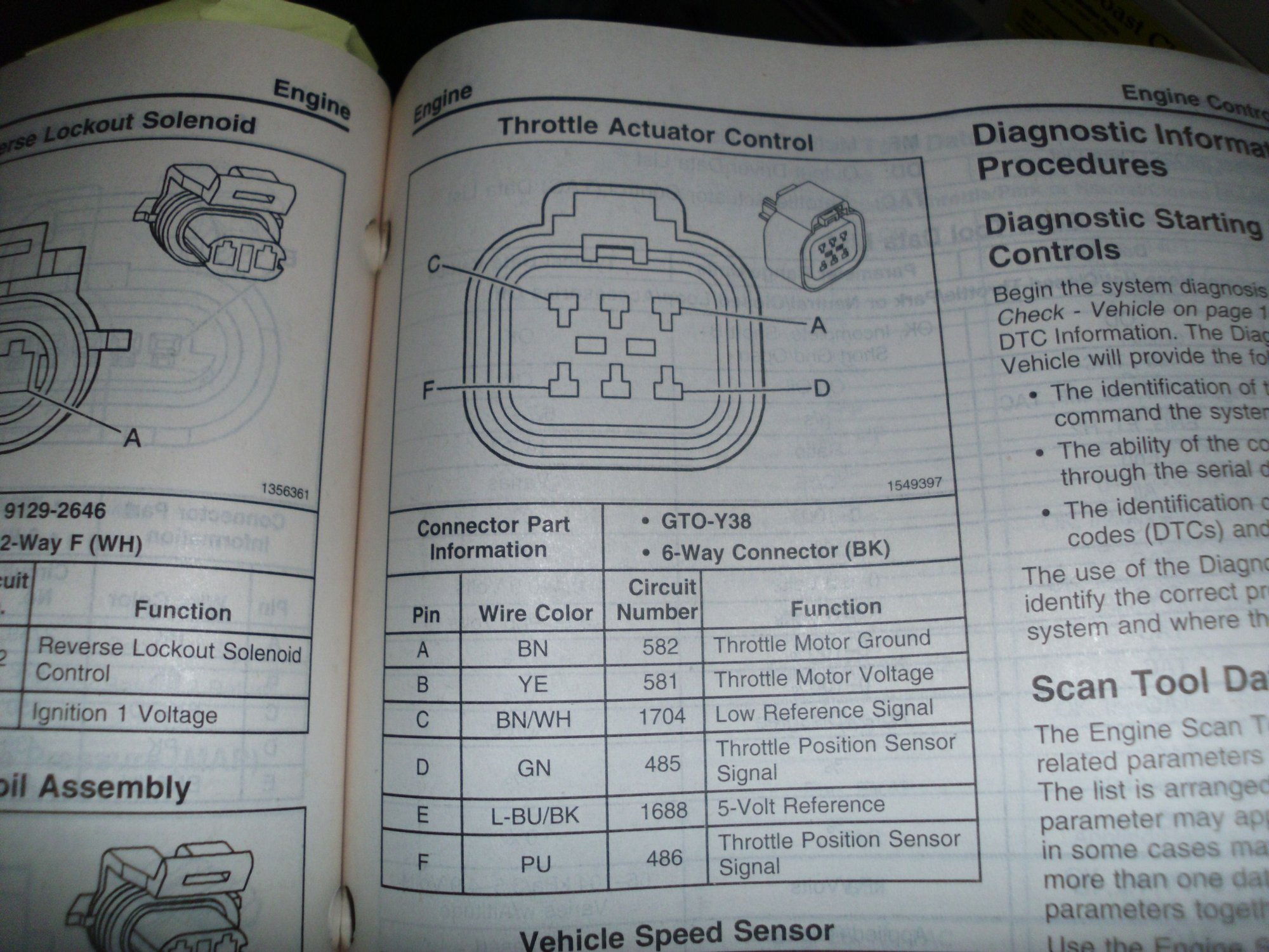

Does anyone know where I can find the pin diagrams on GM part # 12570790, LS2 silver blade TB, so that I can figure out if I need to swap any wires from my 08 TBSS pedal and E67 ECM? I have the pinouts for the connector but want to be sure they match the TB connector. Thanks!!

I hope this helps.

Thank you, this is the harness end view but it will help me in troubleshooting. Appreciate your help!
