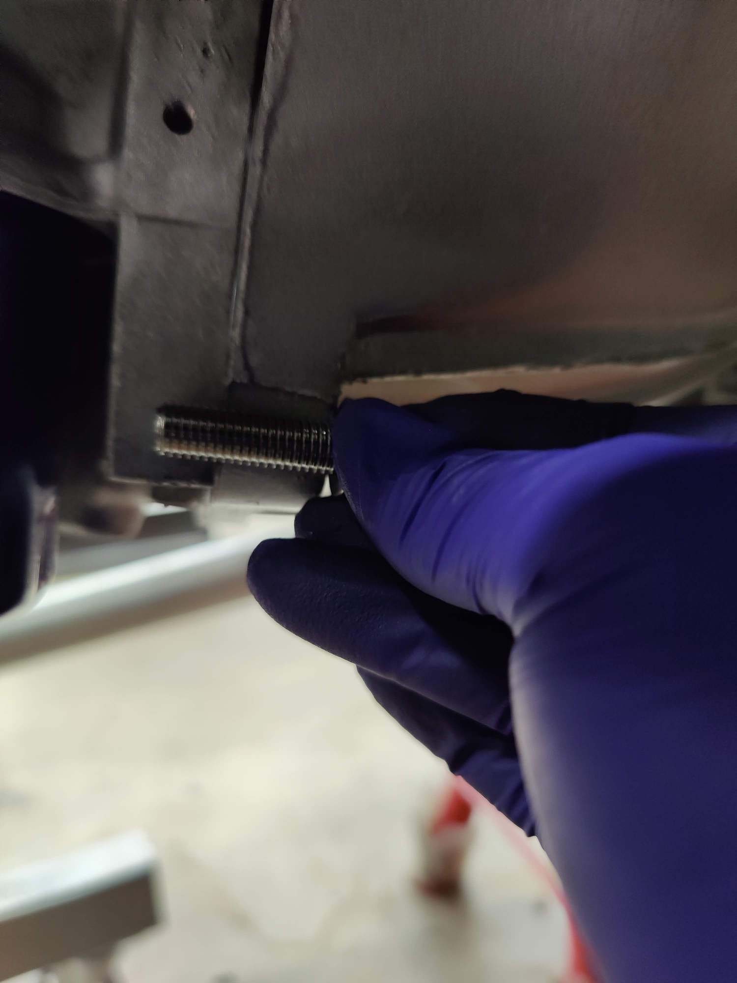

6L80e to LS3 - enough thread engagement?

Using ARP 434-0902.

Thread engagement needs to be at least twice the diameter of the bolt.

Definitely not enough.
