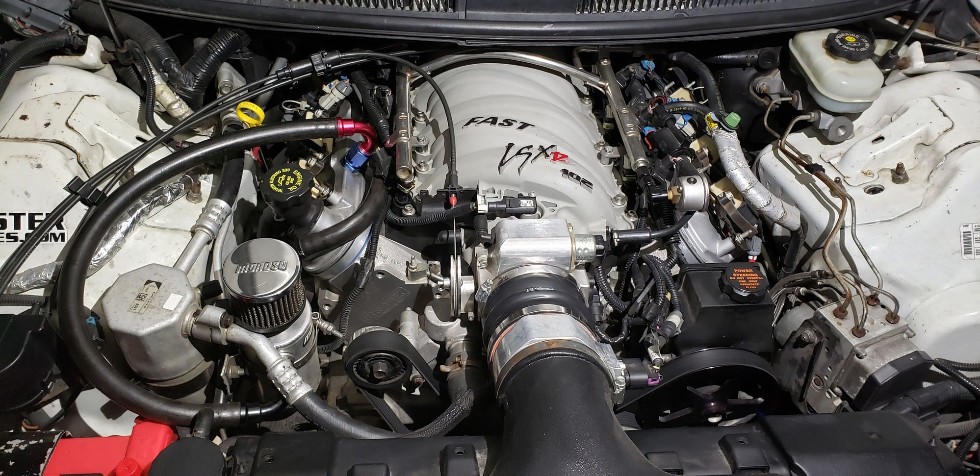

10AN lines from each valve cover to a breather can and a 3/8" line off the valley cover to a small breather tucked away in the passenger fender. Cap off the intake and throttle body ports.

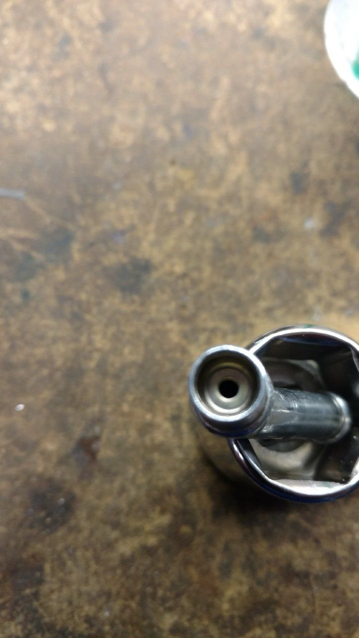

Remember on any PCV you need either the PCV valve or a restrictor like GM does with a .100 hole. Here is a photo of the valley tube you have on the LS motor - you can see restrictor in there. If you do not run this the manifold air intake will suck to much in and you will get a lot of oil in manifold. If you are just running breather to atmosphere that is fine. But the PCV system need some restriction or it becomes a big oil sucking vacuum leak.

Your valve covers do not have this provision either so if you're planning on running PCV you'll need to get an inline PCV valve and route the lines as in post#4 to a sealed can then out of the can through the inline valve then into the intake manifold. Which way is better? That depends on its intended use and what it is your doing but in order to be emissions compliant you need to run PCV and if the vehicle inspector notices that it's not then he could fail you.

Cap off the intake and throttle body ports and connect a hose to a breather on the driver side and another one to the passenger side. I don't believe that either of your valve covers has the orifice as shown in post 6 and I'm not sure what the baffle's look like but feel those should be adequate for venting the crankcase. I would prefer larger openings in the valve covers such as 10AN fittings and larger 10AN lines to dual breather cans but a single breather can has been getting it done on my LSX427. It was just recently that I added a 3/8" line and small breather to the valley cover port which you do not have but you could replace the oil fill cap with a breather style cap and that will give you another place to ventilate the crankcase.
