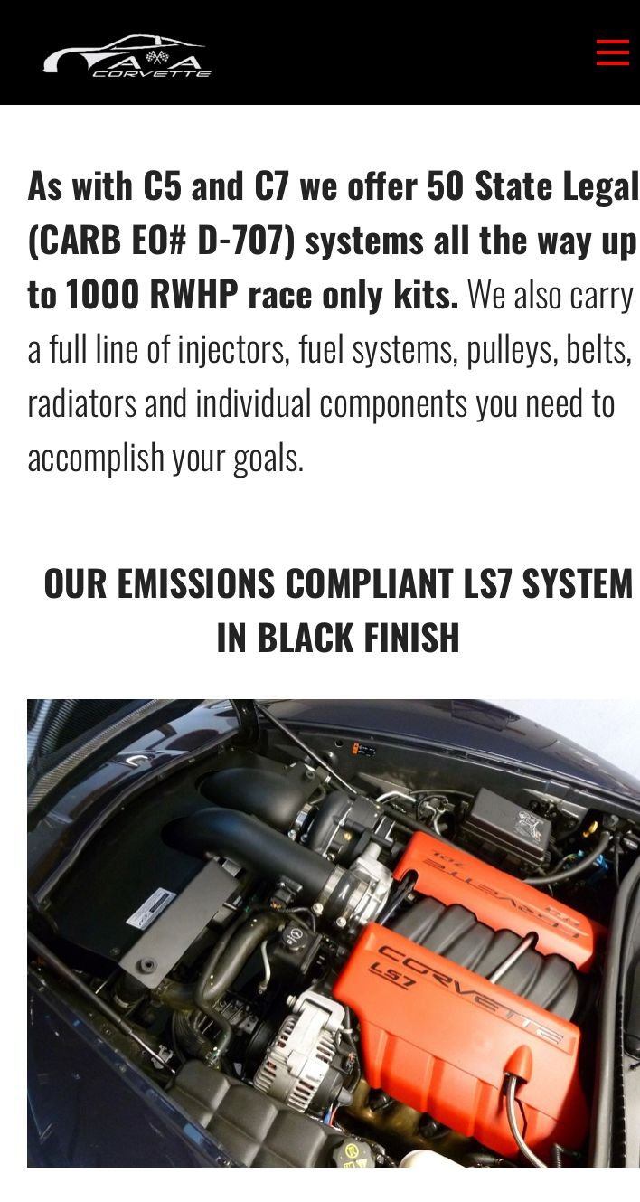

Does the A&A blower have a CARB exemption?
Old Jan 19, 2022 | 07:53 PM
Lght Spd's Avatar
Joined: Jan 2022
Posts: 59
From: Azusa, California
yes it does
