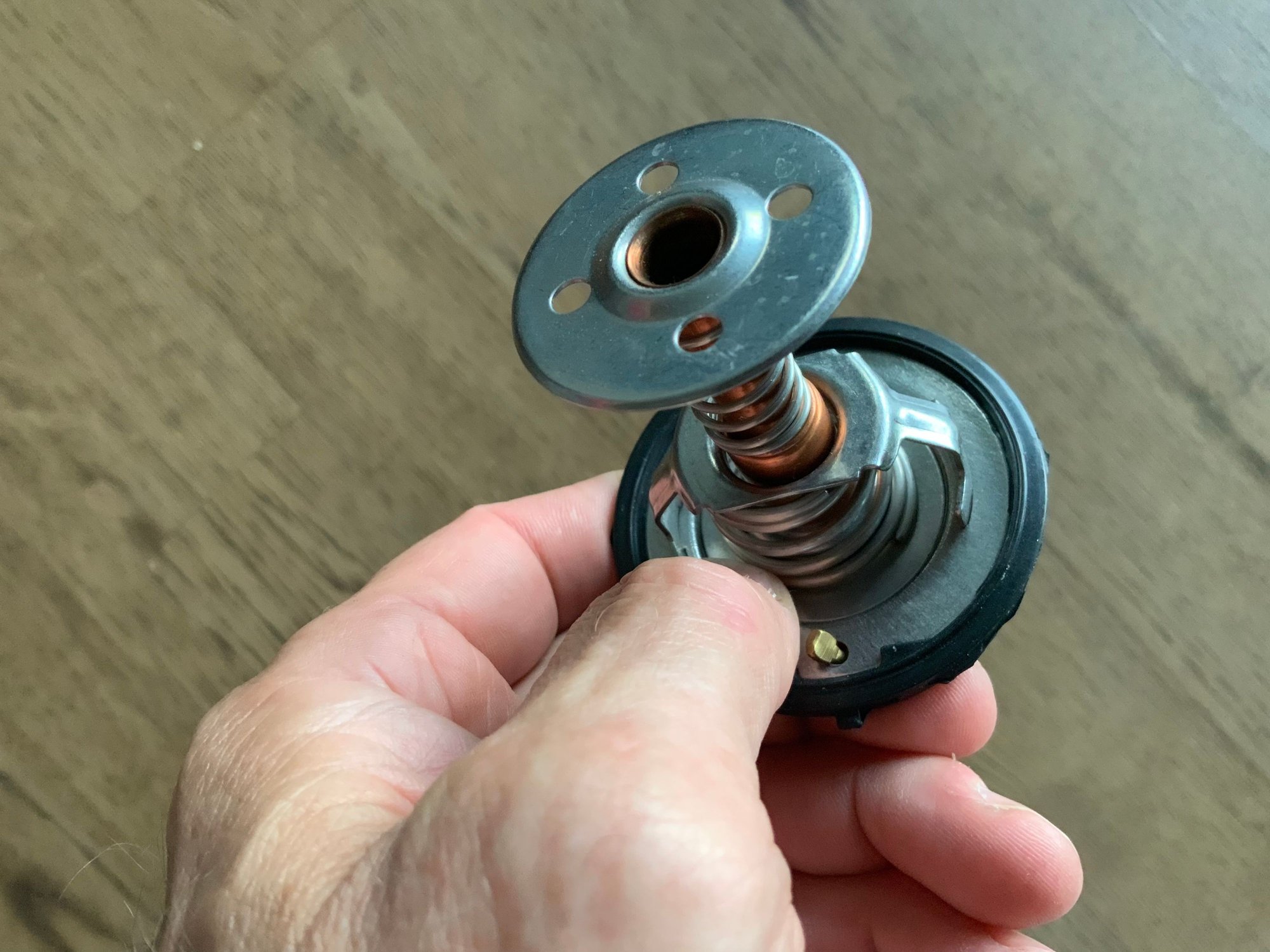

The gen III and IV LS differs from the SBC and BBC in that the thermostat is located in the inlet/cold side. It’s for several reasons, to avoid vapor pockets near the thermostat and thermal shock to the radiator among others. It means it takes longer for the t-stat to open if no ”hot” flow over it (ie plugged heater fittings).You can avoid this by using a t-stat as the above pic, it just takes a slight flow over the t-stat.
But if the t-stat seals good between hot/cold side and no holes in the t-stat you might have a initial overheat condition.
