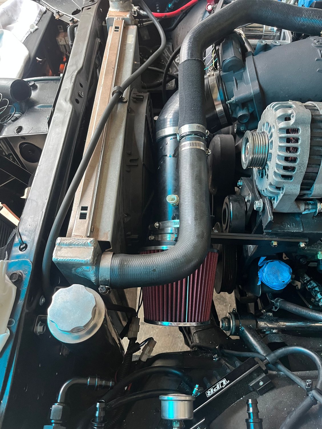

Hi guys
I’ve got a 4” tube with a small cone air filter on my LY6 (ls3 heads with a mild cam)
Do you guys think this air filter be holding back my combo ? I’m limited with room.
thanks

Likes: 329
From: Missouri
the filter / tube set up probaly flows just fine, id be more concerned about the proximity to the heat source its up against. engine masters had a good episode testing tubes/filters and i think the bends made more restriction than any thing else. but again that thing is suckng up hot air for sure.

Posts: 48
From: Callahan, Fl
Looks legit, should be fine, especially if the small end is a reverse cone filter.

Posts: 14,628
Likes: 1,778
From: FL
It looks like if you redid the upper coolant hose you could straighten the piping and run twice the filter. That little guy going into a Hiram just seems odd. What's your map reading at WOT? That'll tell you.

Posts: 22,292
Likes: 3,616
My concern is breathing hot under hood air. IAT has to be high. Maybe too high...

Posts: 367
Likes: 43
The car isn’t running yet.
But I wonder how bad it is to be close to the rad
may be interesting to do some 60-130 testing with current setup and then a bigger filter
