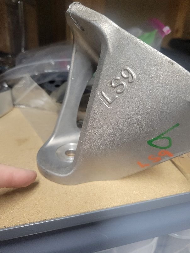

That's the first I've heard of that and don't think its true. There has been a few Z06's with LS9 swaps and no mention about different engine cradles. The LS9 blower is pretty much flush to the cowl.

Its the engine mount that is lower. The thing that is between the donuts and the block. I compared it to my Z06 the bottom part on Z06 is say .550 and the ZR1 is .400. I bought ZR1 mounts and compared. That being said I think the later years LS7s like 2012 Corvette or so got the same mount as the ZR1. The other side motor mount I have has LS7/LS9 engraved on it - this one just says LS9. I have a 2006 and the area I am pointing to is thicker by .150 or so. A guy on Corvette Forum did the swap and turned out it worked. That is how I know about it.

Thanks Double06 for clearing things up for me.
I didn’t explain about the brackets very well.
maybe this info will help grinder11 from cutting on his car
