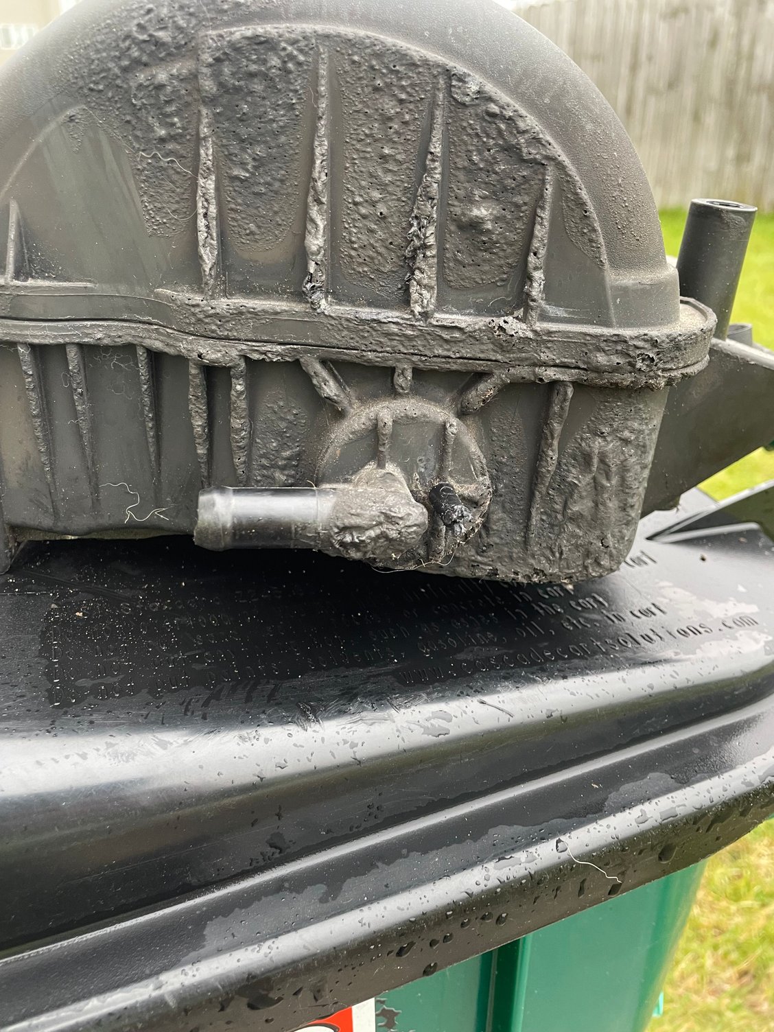

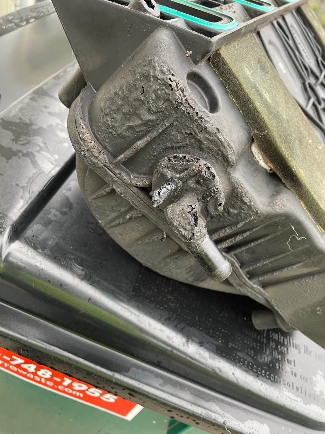

Car had a fire from an improperly seated injector. Not interested in an aftermarket intake at the time as I will be doing FBO,H/C And stall altogether to not get hit by tunning fees everytime I change something,so I have to stay stock for right now. What would you guys do to fix the small vaccum line ? The bigger port
isn’t pretty but doesn’t look like it burned through.

you could cut it off and thread in a brass barb....for 1 or both
thank you kind sir . You fixed my headache and saved me a few bucks . Much appreciated.
