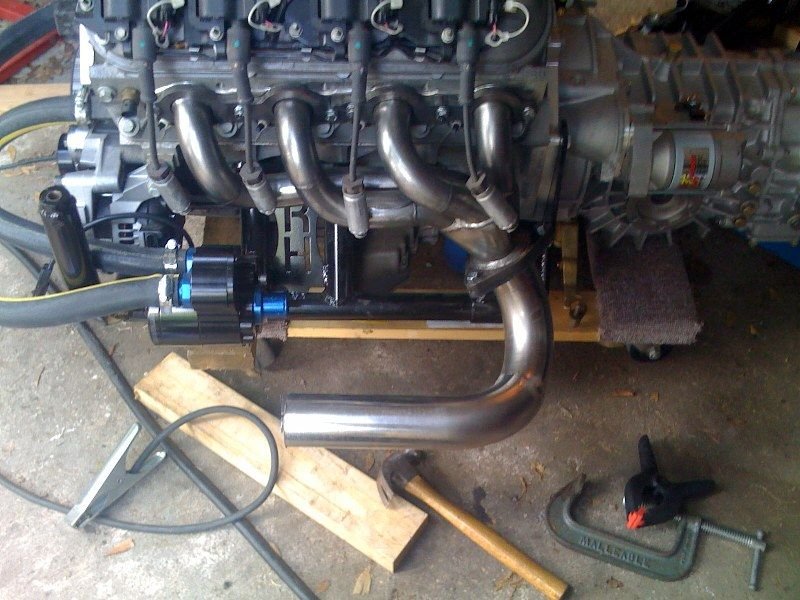

In a vintage Porsche swap, the engine is reversed with the harmonic damper facing the rear bumper. Therefore, the headers are bolted on the normal way, but you have to run a J-bend pipe in the reverse direction. I was wondering, based on the pics below from someone else's engine (using the JBA 1850S-3 headers), what 2.5 inch OD J-bend pipes were used to weld on to the bottom flanges? It looks like I need a 135 degree J-bend, and part of a 45 degree J-bend, or should I get a 135 and a 90, and then cut out what I need?

You'll more than likely find 180 bends most easily.
Just cut at the degrees you need and go fab crazy.
The leftovers will likely come in handy elsewhere in the system

Thanks - was thinking about a 180. I've seen 3.5 and 4.5 inch radius 180s and I'll be leaning toward a 4.5.

The radius mostly comes down to what will fit.
Obviously the bigger radius the better, but some areas will leave little choice
