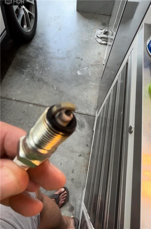

Here's a pic of a plug I pulled .... not sure if that tells anyone here something
Have begun looking for another tuner

It looks like it's been fouled but tried to clean up. I'd put new plugs in it before someone else tunes it.
