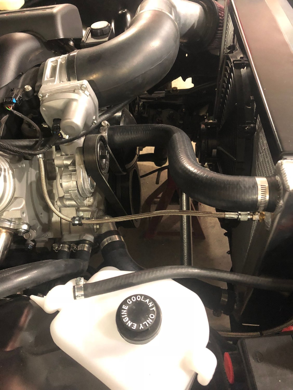

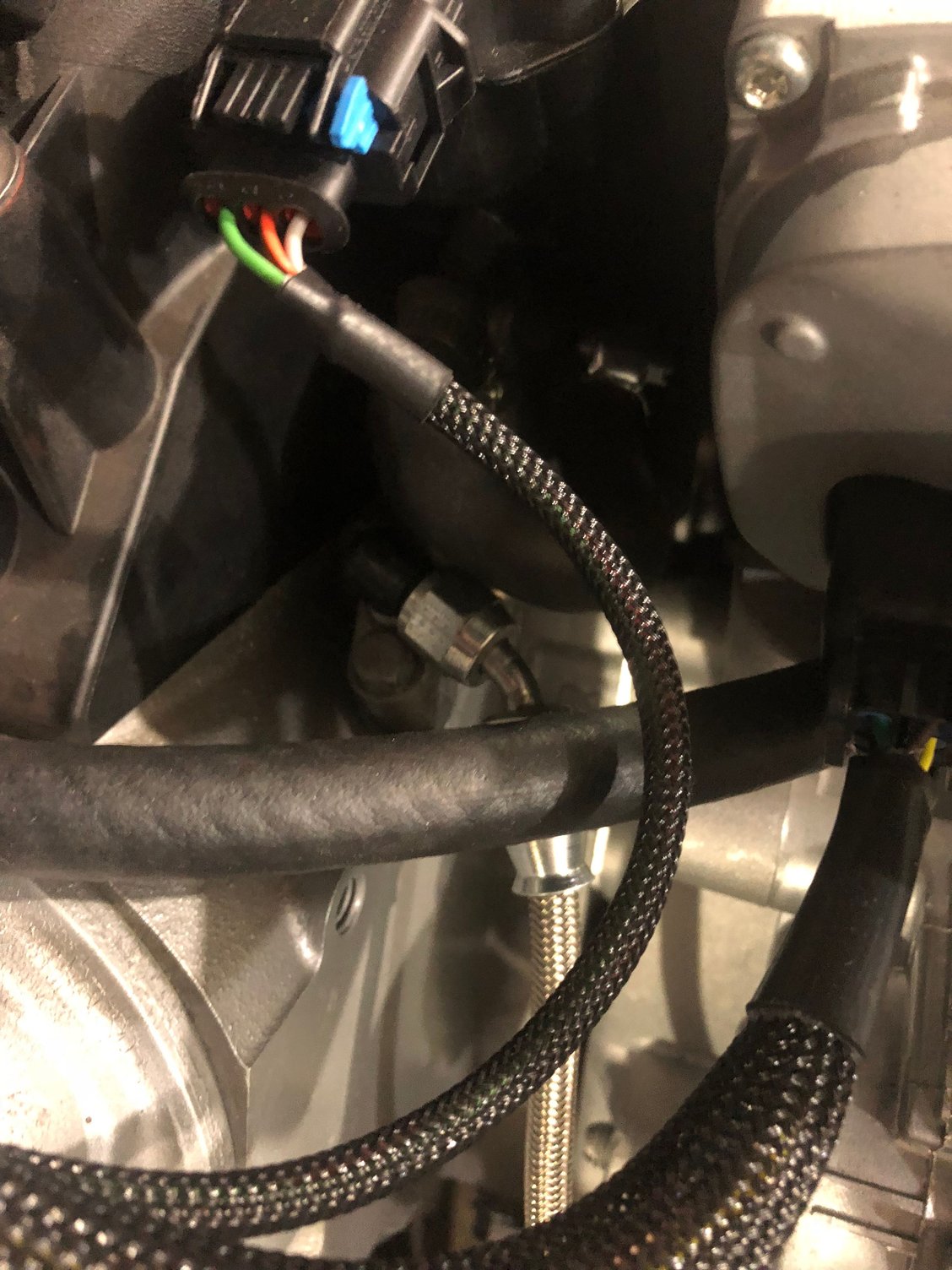

On my 2010 and 2012 L92's they only have the front steam vent. One thing I do is cut off the right side nipple and then drill and tap for 1/8 NPT. Then using -3/4 SS brake line I add a 1/8" port to the radiator.
Couple of pics.
