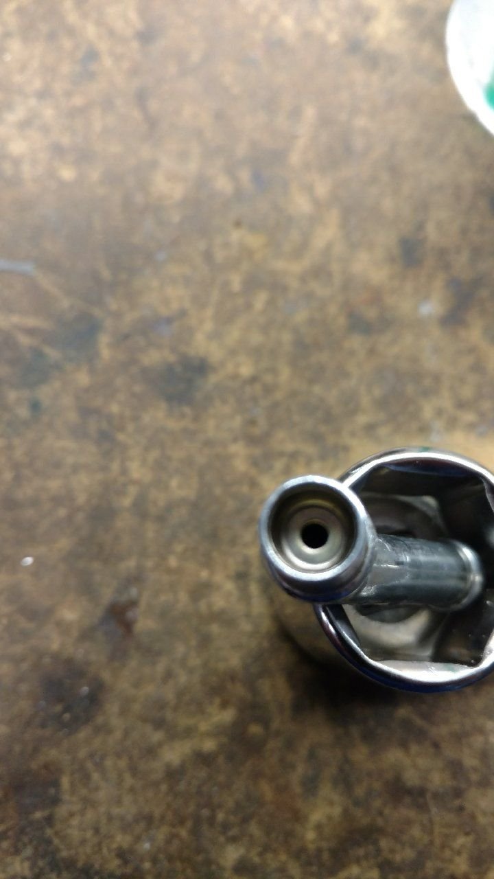

The PCV should have a restrictor in the valve cover of .100 or so or just an old fashion PCV valve. Here is a photo of what some LS motors have in the valley pan note the small bottle cap plug with hole in it. You also need a fresh air breather what do you have there? A photo of your set up in car might help us too.

Correct, I did have an inline PCV valve on my setup previously. I used an inline rather than built in because my Holley Valve covers had no build in pcv like factory covers. They recommended the Beck Arney inline PCV valve. I am also running a WS6store catch can setup. After emailing back and forth with him regarding my setup, he suggested removing the inline PCV because his catch can provides enough restriction in the catch can itself.
As far as breather, it is my understanding that there should not be a breather on an LS running a MAF. A breather would allow for unmetered air, which kind of defeats the purpose of the MAF and will making tuning difficult/impossible. Is this not true?

You need a breather they are connected to the accordion thing in front of the throttle body. So it does breath it gets recycled. All LS OEM cars have this. The valve cover has a straight no restriction 3/8 tube that goes to the intake to accordion ting in front of the throttle body. Under load the pressure from the engine goes to there and is recycled in. If you do not have that your PCV will not work as there is not fresh air source and under load it will blow seals as the engine needs a vent. A typical LS could have like 10 cfm or more of excess air leaking past the rings that needs to go somewhere. The PCV at best is 1-2 cfm. So the rest goes to the air bridge and is recycled through. If you do not have this system you need vent somewhere like one of those Moroso cans with a little air cleaner on top. Looks like you have a hose from your VC to the throttle body in drawing. Just make sure it is an unobstructed tube (does not have a bottle cap restrictor in it like above). You need a PCV restrictor or you will fill the catch can of oil. With restrictor (.100) the PCV flows 1-2 cfm at like 15 inches of vacuum without restrictor it will flow 15 cfm and will suck oil in. You can run a valve cover breather it just can not be connected to anything (with your MAF). Take a photo so we can see components and actual hook up.
