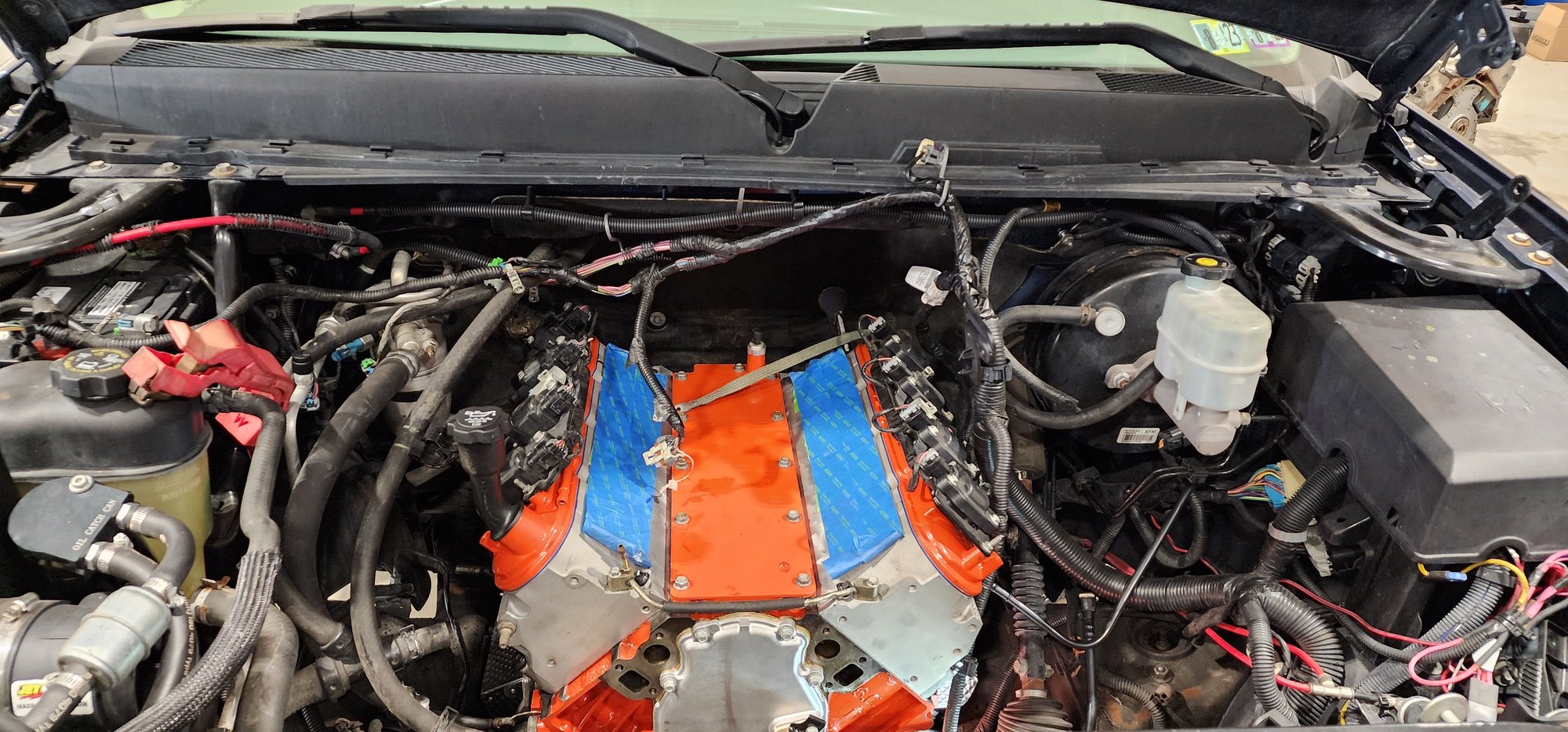

Hello All
I recently posted about this engine stumbling at low rpm loaded and I didn't mention the no start on hot restart. I thought this was two different issues but after thinking about it maybe they are related.
The engine starts cold with no issues. If I run a while then shut it off and try and restarting. It won't start. It cranks and cranks and maybe sputters a couple times but mostly no firing at all. If I quit cranking and try again it starts up normally. The best example is I run to the store and run it to grab something and come right back out and try to start. I now give it a short first crank and quit then it will usually fire up the second try. It seems if it sits for more than 20 minutes it starts with no issues. Last week it backfired through the intake on hot restart then ran normal. I'm starting to think the crank position sensor might be the issue. I have seen sensors act up when hot then work when cold before.
