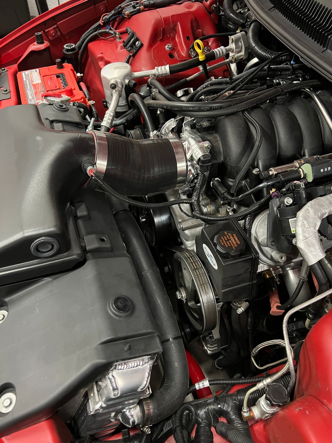

I ordered the 22 degree hose and T-bolt clamps. It's on back order, so it will be a while before I get it.

Finally got the engine swapped in. I’m really liking this MAF delete. Thanks for the recommendations and advice. 👍
