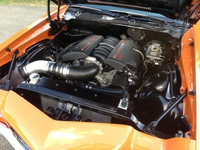

I used the Texas Speed VVT L92 delete kits twice. Worked great. Didn't go carbed but went with a LS3 intake on both swaps.
3 bolt cam.
Replaced the timing chain guides from the spring loaded type to earlier style plastic type.
Also IMO new push rods, valve springs.
Pic of my 80 and 73 Camaros with L92 swaps.
