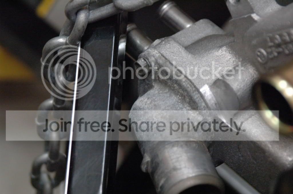

What are my options for a skinnier water pump? The ls7 water pump sticks out from the block too far for my application (kit car).

I have been told the old ls1 water pump will make it all fit, but have not put it on to confirm this myself. The new style water pump is 3 3/8" deep while the old style water pump is 3 1/16" deep so if its true that it will fit with the old style, I only need it to be 5/16" skinnier (3/8" skinnier would probably be better).
Fitment:
Depth measurement (7 3/8 - 4 = 3 3/8"):
Old LS1 water pump depth (7 1/16 - 4 = 3 1/16"):

i just got my meziere delivered today. The mounting depth from where it bolts to the block to the face of where the oulet attaches is 2 3/8" only.
i'll post a pic in a few min

Damn, thanks for that picture. I sourced a brand new old style LS1 water pump from the local NAPA.... maybe I should go with that Meziere anyways since it would give me even more clearance.
