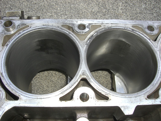

hi
do i need to rebore my block
i would rather not....

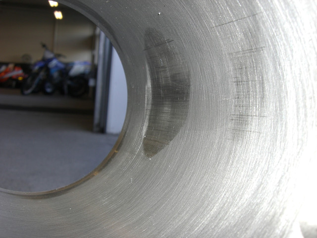

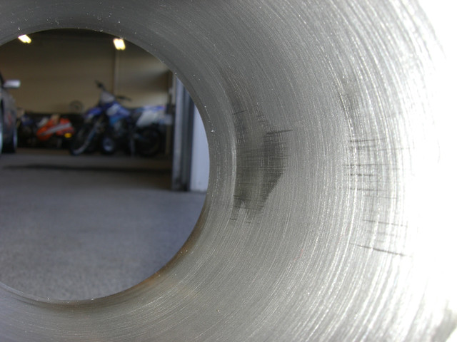

Old Sep 30, 2010 | 01:49 PM
Jontall's Avatar
Joined: Sep 2005
Posts: 1,584
Likes: 23
From: NYC
You sure do.

Originally Posted by Jontall
You sure do.
if you can feel it with your finger nail it needs to be machined

we are gona bore it out to 4.010" from 4.005", and offcourse new pistons
so from 402 to 404ci
thanks
baezi
Old Sep 30, 2010 | 03:42 PM
Busted Knuckles's Avatar
Joined: Oct 2007
Posts: 301
Likes: 20
If you're going out from 4.005" to 4.010, it won't be bored, just honed. Still no sweat, and it saves you the cost of boring ;D

Originally Posted by baezi z06
can it not be bored out .005"
and will an just hone be as accurate
Everything that is bored is always finished with a hone.
Boring = rough cut to about .005" undersize
Honing = finish cut, much less material and add proper cross hatch. Last few thousanths.
