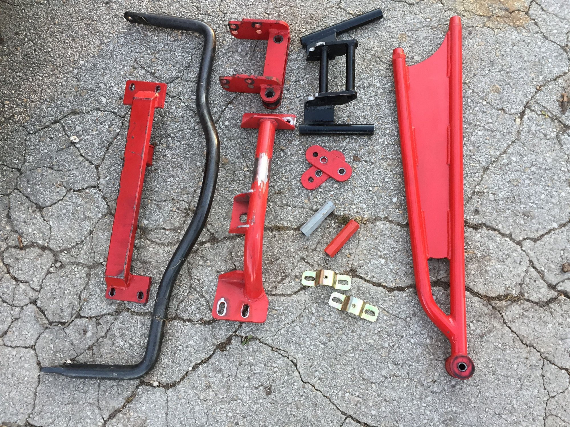

Most my suspension/chassis parts cleaned up and prepped for re-powdercoating.
Looks pretty good huh?
Once it warms up, I'll finish this off with a good set of 3/8" pushrods, torque everything down, adjust the drag bar, do fluids, upload the tune, charge the battery (replace it most likely) and hit the streets for the first time in 2 1/2 years.
