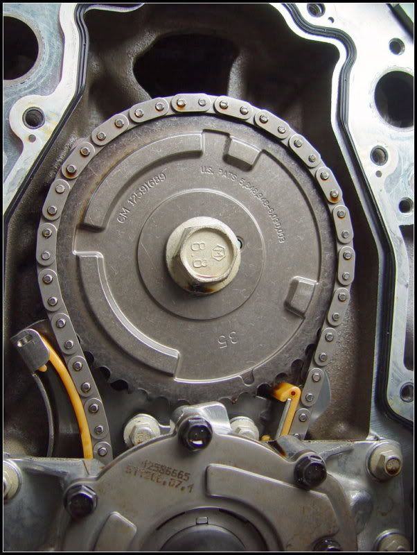

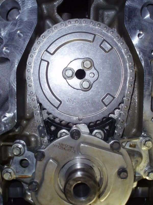

If you have this gear:
Then you'll need to swap it for this gear:
TX-Speed shows it listed for $19.99...
