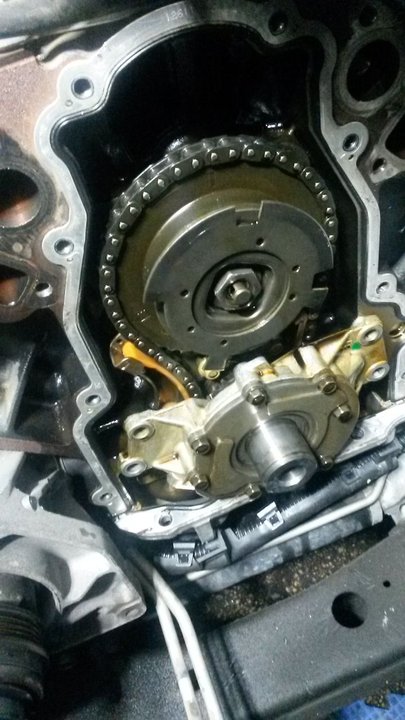

Ive been trying to remove this 2011 4.8 cam gear but i can't figure it out because every time i try turning the nut, the timing chain spins with it not letting me loosen it. Any help and advice will be greatly appreciated, thanks. No negative comments please.

put the bolt in the crank and use that to keep chain from moving. Or use a flywheel stop. How did you keep the motor from turning over when you removed the crank bolt?
