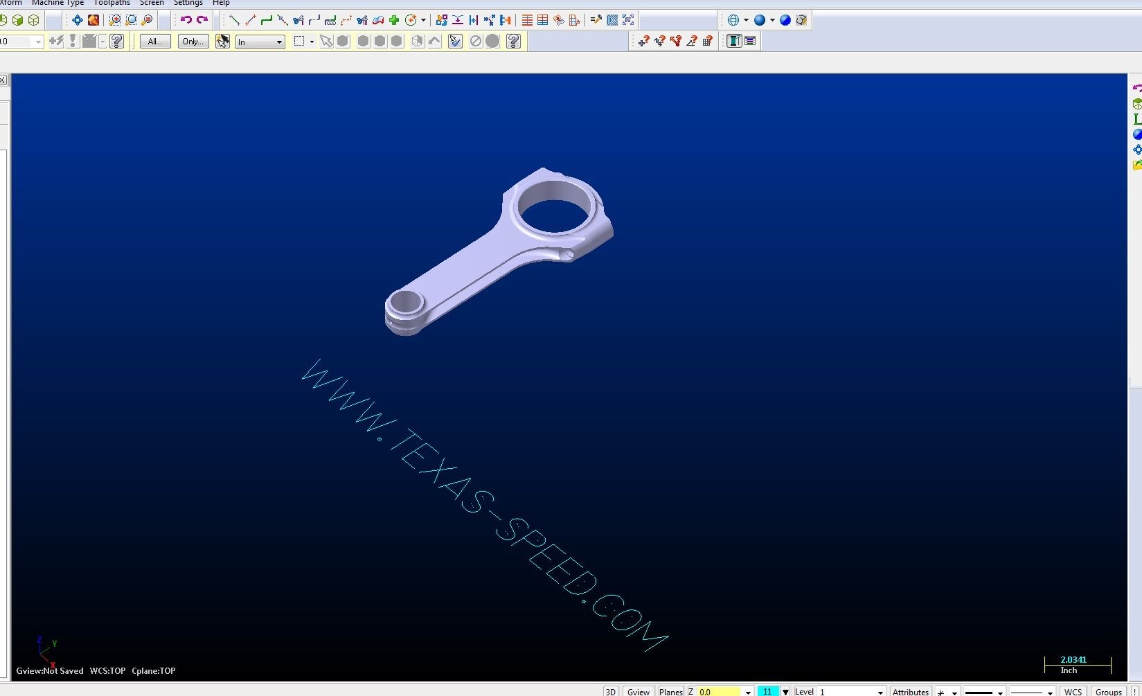

Old Oct 2, 2015 | 01:47 PM
  #37
Jason 98 TA's Avatar
LS1Tech Premium Sponsor
Posts: 4,229
From: Texas!
Thanks guys for the kind words.
The great thing about TSP is we have tons of inventory. Infact there's over 400 sets of rods in stock right now. Needless to say we have every major brand in stock & ready to go.
I just had to respond when people insinuate we just rebox these parts. I have the cad drawing & development stuff on my computer right now from the development of these parts.
__________________
Jason
Co-Owner, Texas Speed & Performance, Ltd.
2005 Twin Turbo C6
404cid Stroker, 67mm Twins
994rwhp/902lb ft @ 22 psi (mustang dyno) www.Texas-Speed.com
Old Oct 2, 2015 | 08:35 PM
  #38
SHovV's Avatar
Joined: May 2008
Posts: 937
From: Rockport, TX
Pretty sure thats Microsoft Paint, but anyway.....
Lol
Old Oct 6, 2015 | 10:09 PM
  #39
Posts: 4,229
From: Texas!
Yeah either that or mastercam
