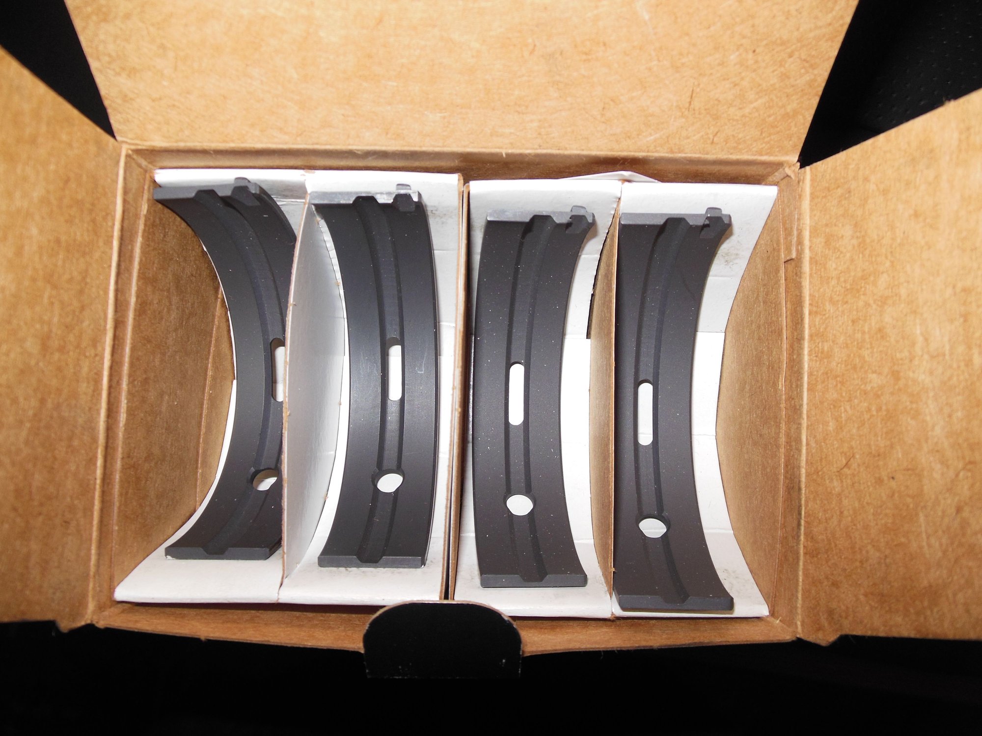

I have an extra set of NEW Calico Clevite MS2294H - H series main bearings.
Specific to LS3 & LS7 engines. Full width oil grove on upper bearing shell.
Standard size.
$175 shipped in the 48 states.
Email: wmstaab@gmail.com or call 404-867-5110
Call CV Products in NC for rod bearings.
