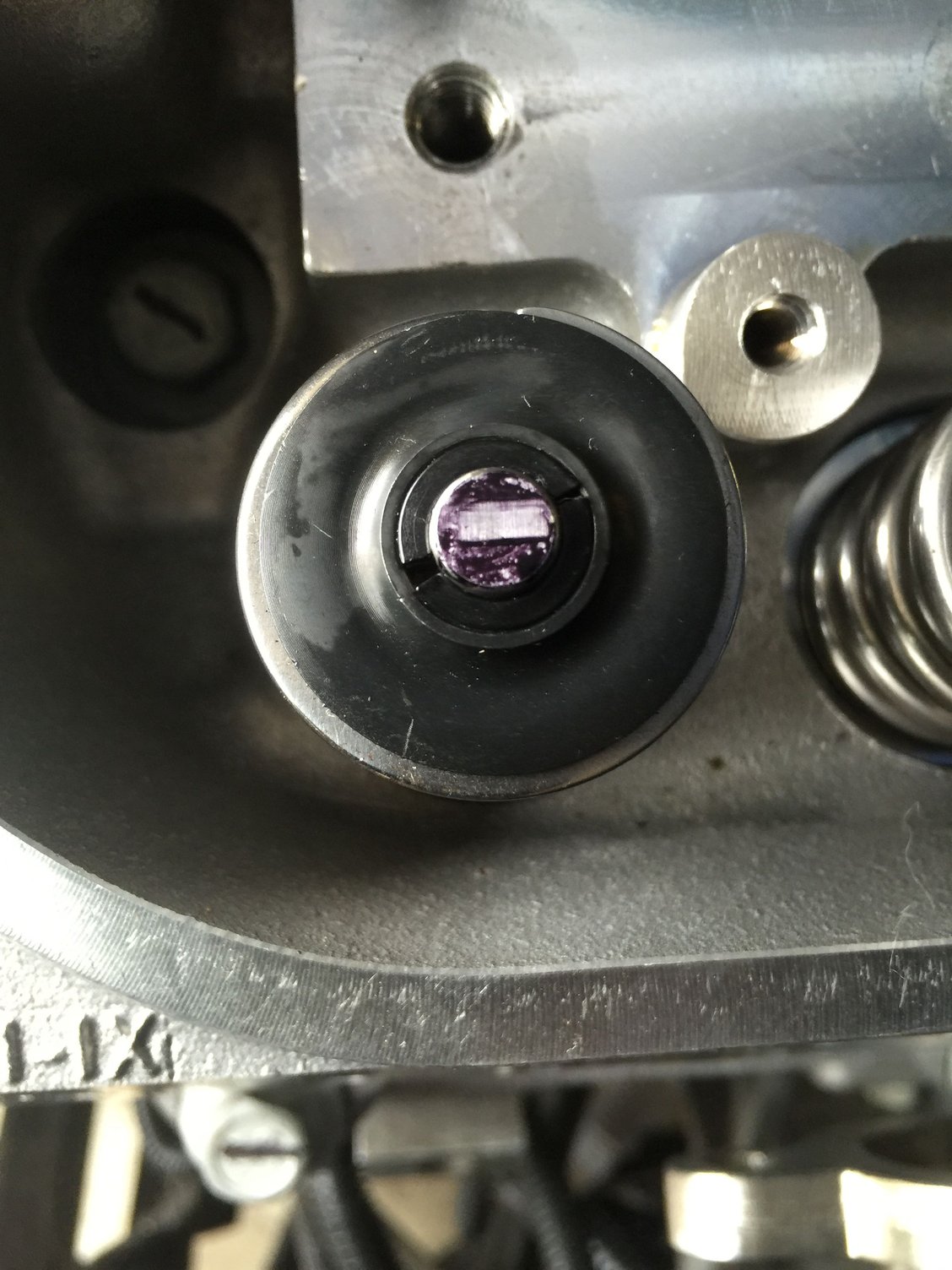

This is what I'm thinking the problem is. Yes, I measured and got a measurement of 7.500. However, I'm thinking this is off because of how loud the valvetrain noise is.
The way that I measured was by taking a permanent marker and rubbing it all over the top of the valve stem. I then placed the bolts in for the Yella Terras and took an extension with the hex socket and threaded the bolts in by hand without a gear wrench. This is what Yella Terra claims will put the lifter at zero lash. I then rotated the engine over several times and then removed the bolts from the Yella Terras. Here are my results:

So did you hand tighten the rocker bolts until you could not turn them anymore or did you tighten them only until all of the slack was removed between the rocker tip and the valve?
Rocker wipe pattern looks fine by the way.

140K GXP, I first got both the intake and exhaust valve springs to the fully compressed position. Next, I took a hex bolt with an extension and hand threaded both of the bolts on the Yella Terras using two fingers. When playing with the pushrod using my pinky, I was unable to move the pushrod around. I also checked to see if there was play in the rocker arm (there wasn't). After this, I took a wrench with the extension and torqued it down to 25 ft*lb's. The approximate sweep after zero lash was an 1/8 turn. I'll try a shim and see how this helps.
