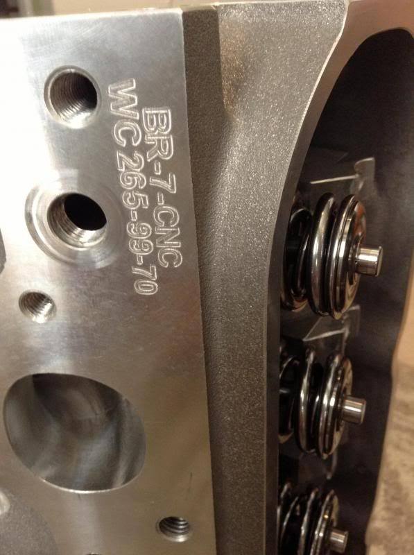

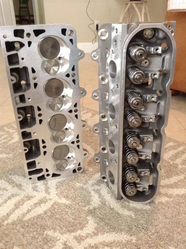

Richard WCCH did my Brodix BR7 Heads almost over 3 years ago...Stage two porting...New DEL WEST Ti/MO intakes, with hardened insert, SS exhaust Valves DEL WEST...CHE rockers, bronze CHE guides, BT dual springs...Valve train is quiet, no issues to date...
