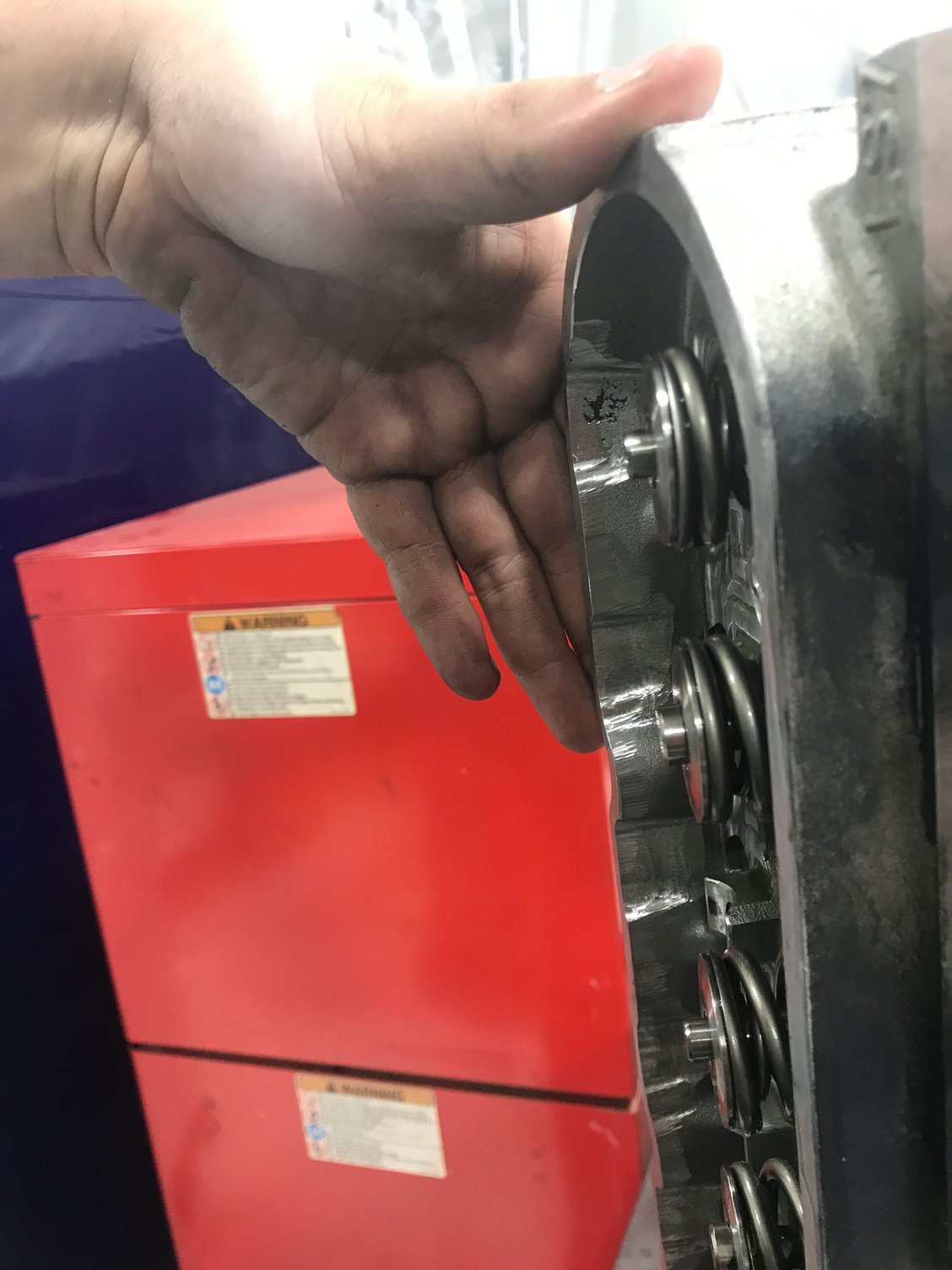

The heads are prc ls7 285 cc heads. The issue is the intake valve stem height is still shorter than the exhaust even with the lash cap on. I knew this was an issue but I needed to make a race so I swapped in stock lifters because of the much larger preload tolerance spec than my morel stuff. Well it lasted for a bit but I killed a lifter and all the exhaust lifters aren't happy. Now I want to fix it right. Are the valves suppose to be cut to spec each time they are built? Are there different thickness lash caps available? Should I get adjustable rockers or run different length push rods?
I used a straight edge and measured the difference with the lash cap on and this is what I came up with
