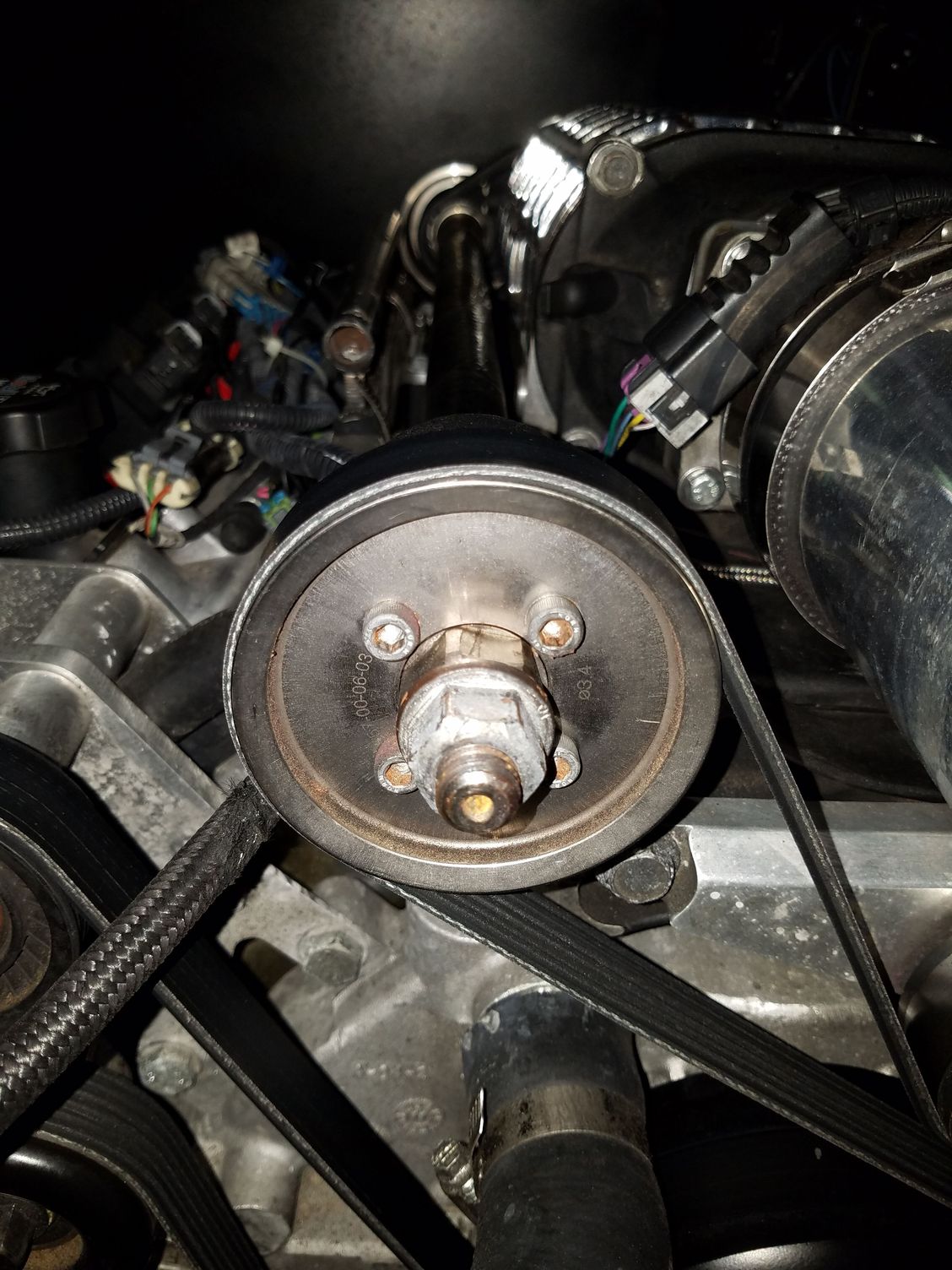

A couple of folks have suggested my tune may need to be adjusted. It was tuned in utah, about 6000' elevation. I'm not at sea level. I drove the car just fine for a few weeks here before it started acting up so I'm doubtful, but open to the possibility. Getting it in for another tune is the challenge.
leblanc1 is offline   Reply With Quote
Old Yesterday, 05:49 PM   #18
Crf450r420's Avatar
Join Date: Apr 2013
Location: Florida
Posts: 462
What drive system is on the blower and how much boost are you running? If it's just a single belt 6 rib then it could be a belt slip issue maybe.
A tuner would be able to adjust things just to test out different ideas of what it is without changing parts. I would likely be quicker and cheaper than changing parts until you find it, but you won't get to learn as much.

Quote:
Great suggestion I hadn't thought of. Yes it's a 6 rib belt system. I believe it's setup for 8 or 9lbs boost. Sadly I don't have a boost gauge.
I wouldn't think it would just start to slip... The belt is fairly new. Is there any dead giveaway to check?

Quote:
Originally Posted by leblanc1 View Post
Well, it's a stock balancer and it's drilled and pinned as required for the super charger. I'll take a peak at it though, thank you for sharing that.
Check the polymer band on the balancer, oil etc can cause it to get loose and cause knock
