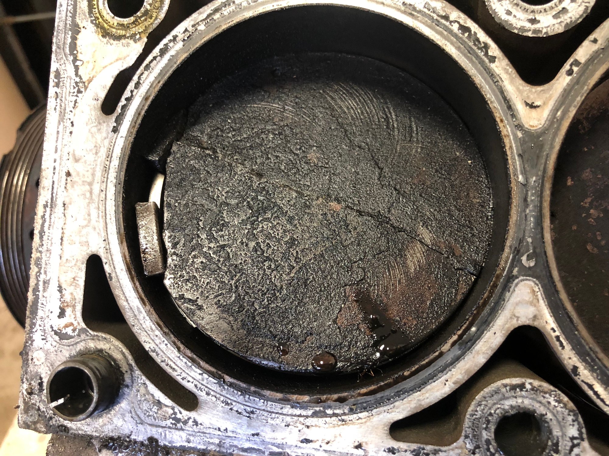

ill probably get 10 wide Toyo proxes or nitto 420. Yeah I’ll get a yanks converter. I’ll show you the motor just opened her up today cyl 1 piston toast and rod not existent.

Looks like you posted a toastie….

Yeah pretty much, sad day for the ls2 guy claimed “spun a bearing” oh well I’d definitely say it did a little more then that..

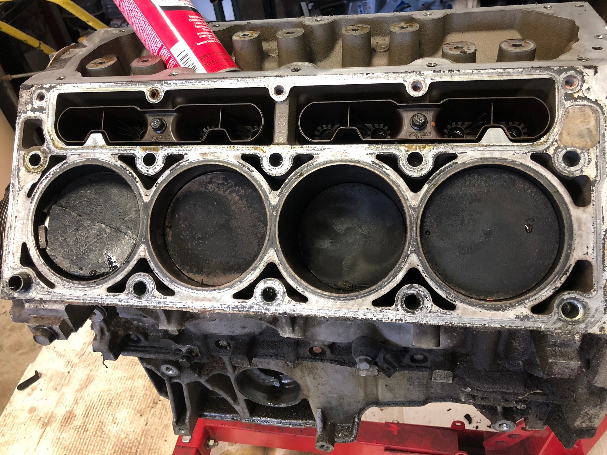

Is block rebuildable?? Usually not a good sign with a broke piston or bad rod.

pulling the pan and the rest off today or tomorrow I’ll keep the posted updated and get some pictures hoping to see little to no damage to the block, but I may not get lucky.

Damn that's pretty bad. Hard to say what happened to the piston there. At first it looked like damage from the ring lands butting together but looking closer it looks like the piston is broke in half?
