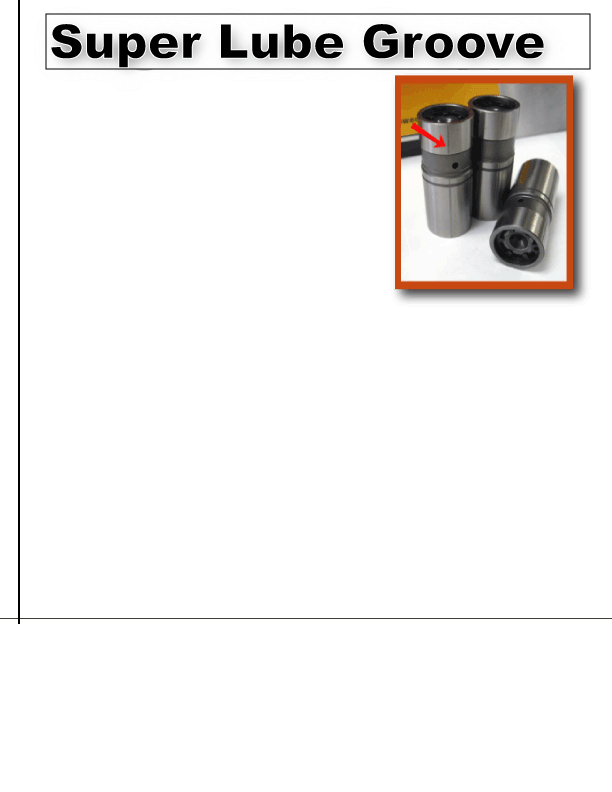

Rhoads has the Super Lube Grove now, I don't recall that back in the 70's and early 80's, sounds like they had at least one major innovation.
Super Lube
Old Oct 17, 2018 | 11:44 AM
Posts: 22,298
Likes: 3,619
Super Lube
Talk about a no-cost improvement! I bet that came about when some poor slob wore a groove in the side of his lifter and discovered things got better lubricated. Hey, it could happen! lol
