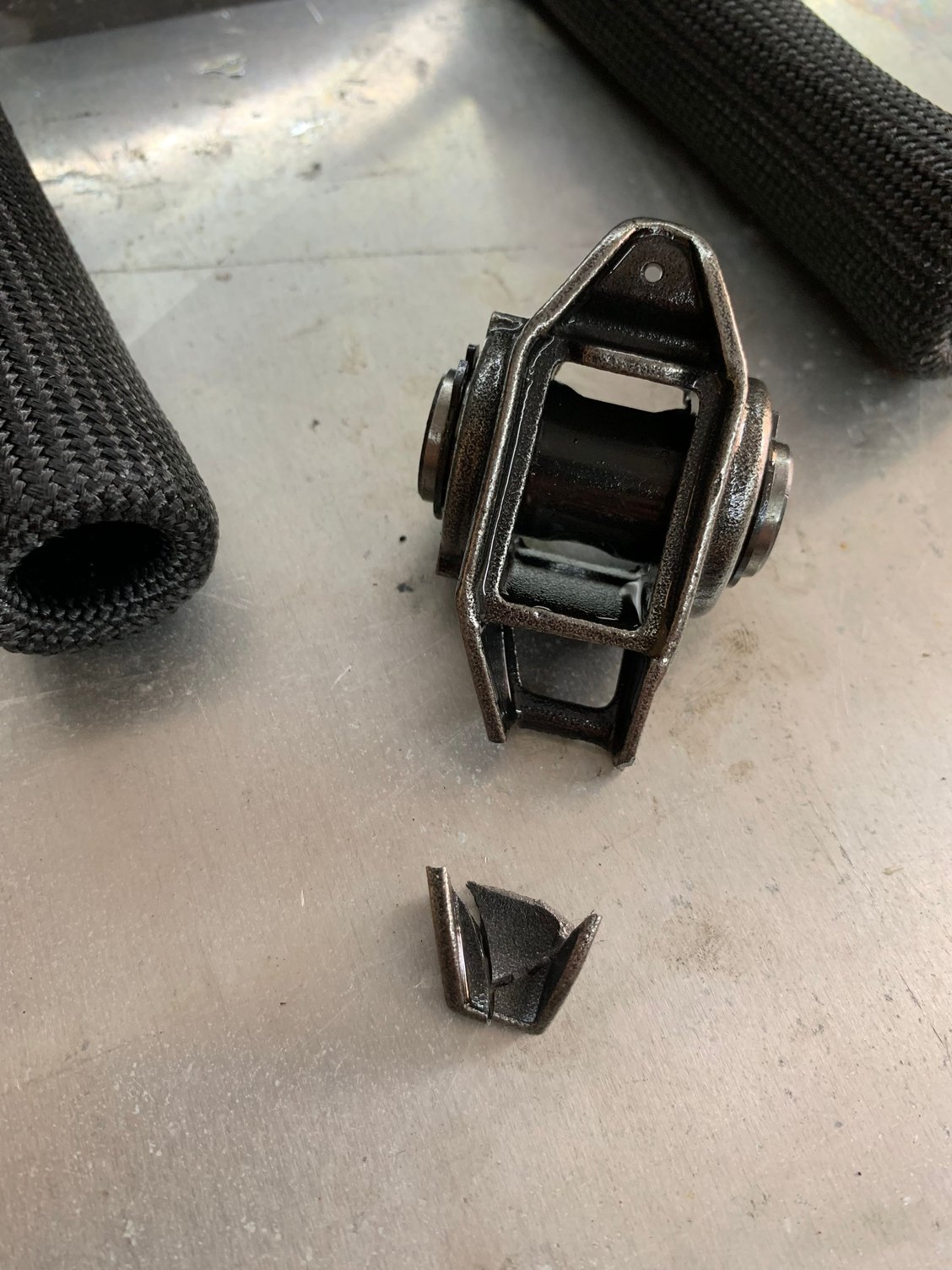

Broke a rocker arm with trunion, btr660 and hardened pushrods after a few hundred miles. Cam is 224/236 .629 .604, 6500 rpms, 7.4 push rods with 90 preload, 105 ptv, heads shaved 20

BOTH the rocker and trunnion broke?

Just the tip of one rocker

Are you positive that the rockers are GM, and not a knockoff? They are popping up lately, ironically in two pieces, on here.

OEM is in the bottom, it also has letters and numbers on them. Was this an ls3/l92 style head?

I wouldn't re-use the trunions either, when I bought mine they came with the comp trunions installed. But I was a little skeptical about that and I ended up installing CHE bushed trunions instead. I had no idea that the rockers were not OEM until I broke one and contacted the seller afterwards. You are the third person that I've seen with a broke rocker from them.

I'd buy some OEM rockers from someone here or another trusted seller and I'd use a bushed type trunion kit instead of the roller needle bearing kind. I went with the comp cam bsr shaft rocker which is basically an OEM rocker installed on a shaft.

The rockers have er360 printed on them, which comes up as enginetech brand via google

Stock rockers with the bushing upgrade would be best as the other options will lead to needing new pushrods.
