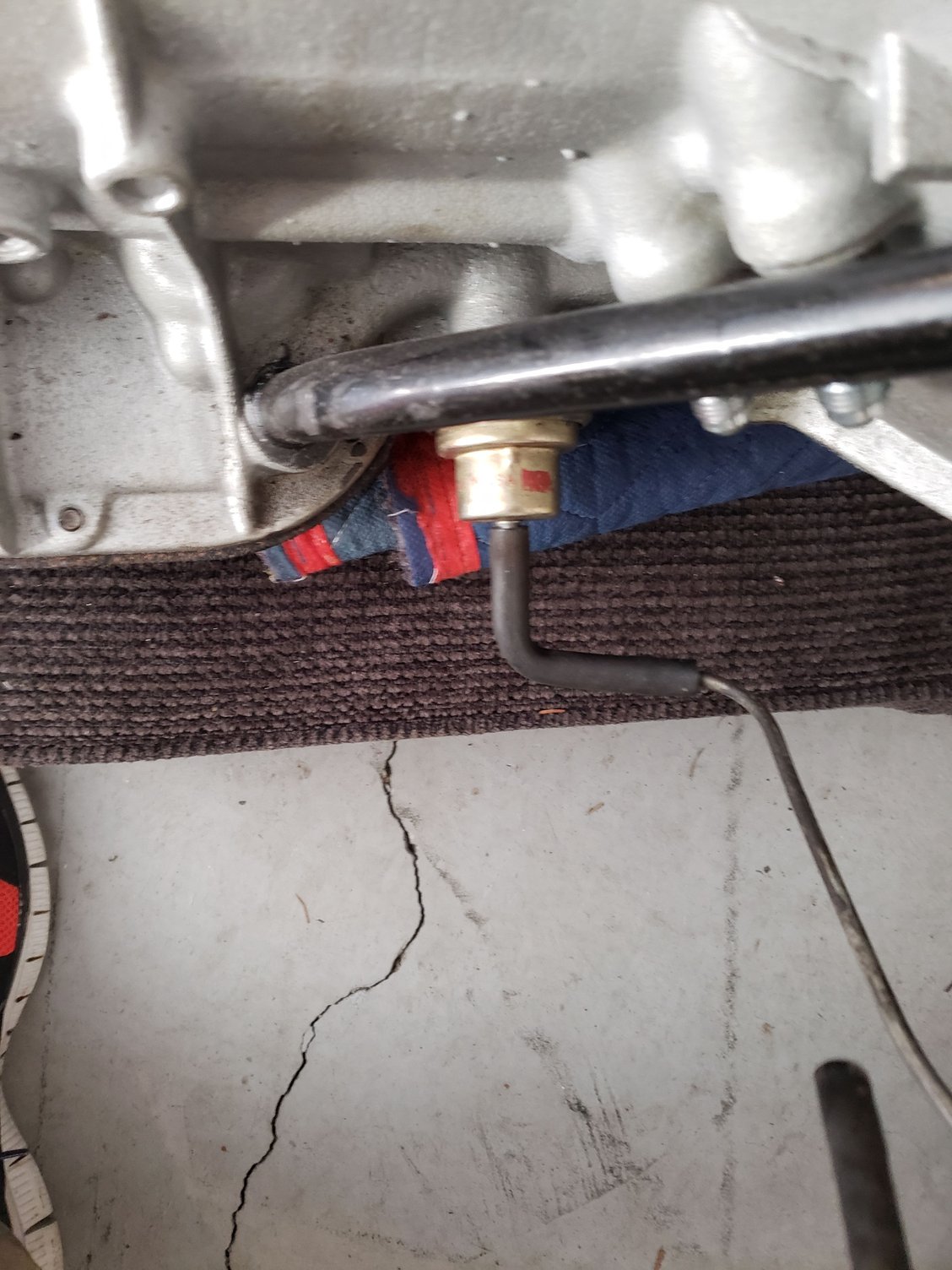

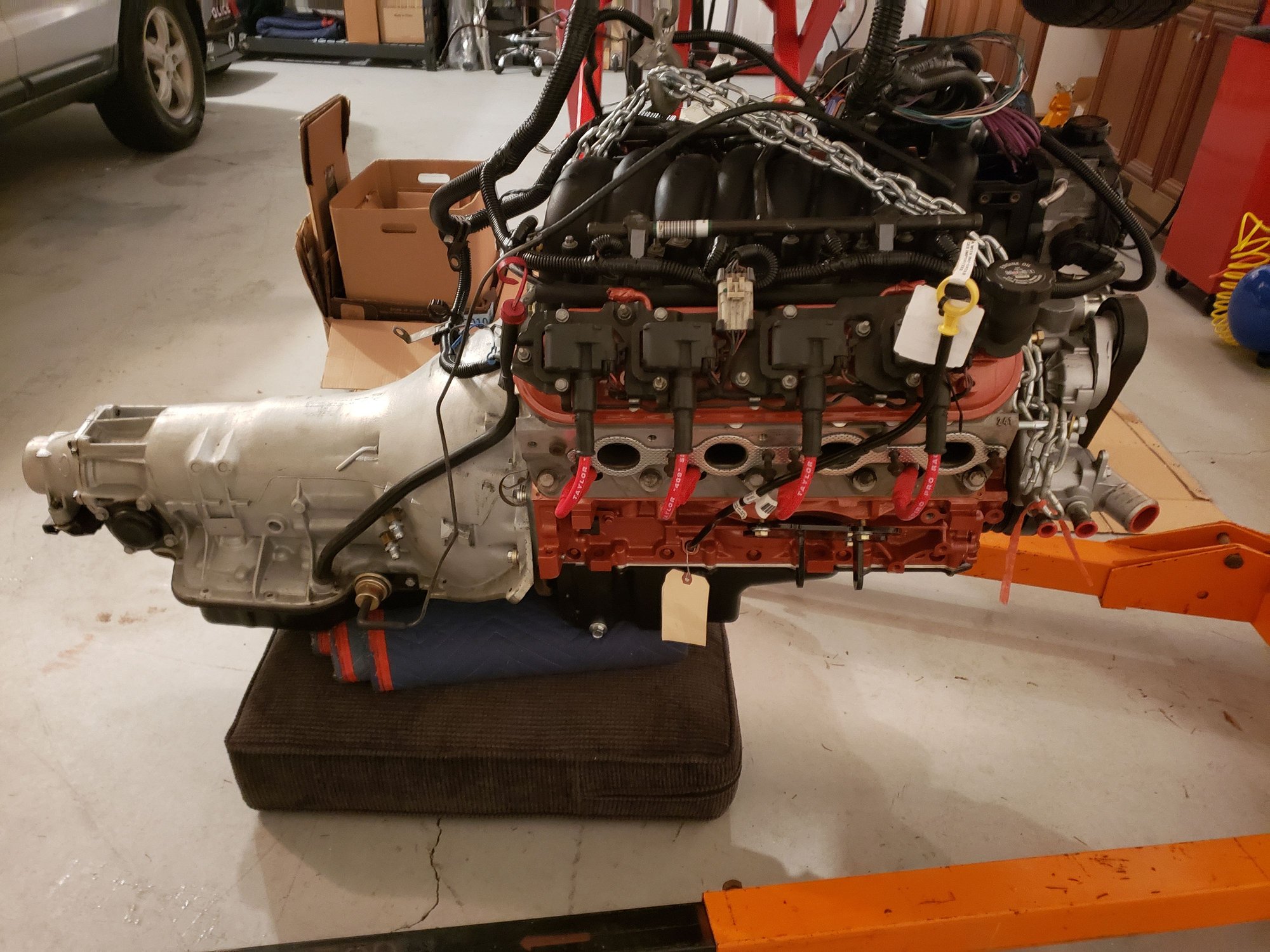

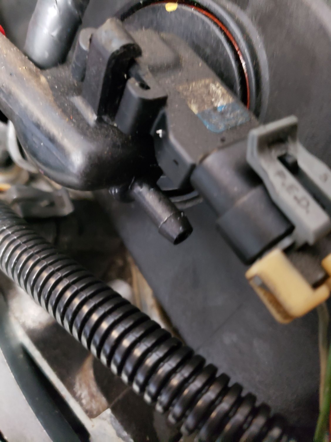

I am almost ready to drop the LS1/Th400 into my 442. I was just wondering if It is okay to connect the vacuum line from the TH400 vaccum modulator to the vaccum nipple on the MAP sensor? Will it provide enough vaccum to shift the TH400?

As long as it can get a solid manifold vacuum signal you're good!
