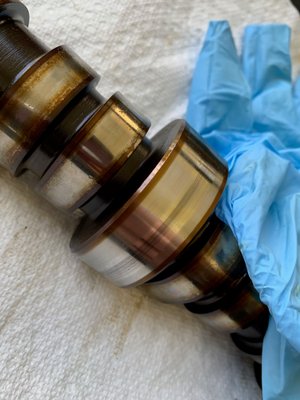

Hello,
I am building a e36 swap LH6. This is my second LS swap.
I have a couple of questions, first about the state of my cam bearings, shown below is the first bearing and how the camshaft that came out look.
There is a large dent shown by the red arrow, it goes in, and the Cam looks perfect in that bearing spot.
Should I be replacing this? Is so, does the whole rotating assembly need to come out?
One of the Cam lobes for the bearing has this mark, can't catch fingernail on it
The second question is a suggestion/recommendation. The power goal is for road racing, high RPM 5.3 NA. I have 799 heads that I wanted to mill 030 down, add a BTR RPM kit and using low travel lifters. I am unsure on a Cam that I could use for this. I am looking for something very aggressive but that I can spin reliably to 8000 RPM.
Thank you for all the help!

It looks like after doing a bit more research, responding to my original questions. The rotating assembly does have to come out to give space to check the cam bearings are installed properly. Now to find a shop in Central FL that isn't crazy booked.
For the Cam suggestion, it seems that the RPM I'm aiming for is not really going to be making any more power. I think my setup would be for something like:
PRC CNC 799 Heads
Johnson Lifers
GM ASA Cam / Howard ASA Cam / or the "Hot ASA Cam" (still not sure about this)
Ferrea Hollow Stem Valves and Ti retainers

And you are right. No point spending money on everything else and not do it right. I will have the cam bearings replaced and have a shop look over the rest of the block.
