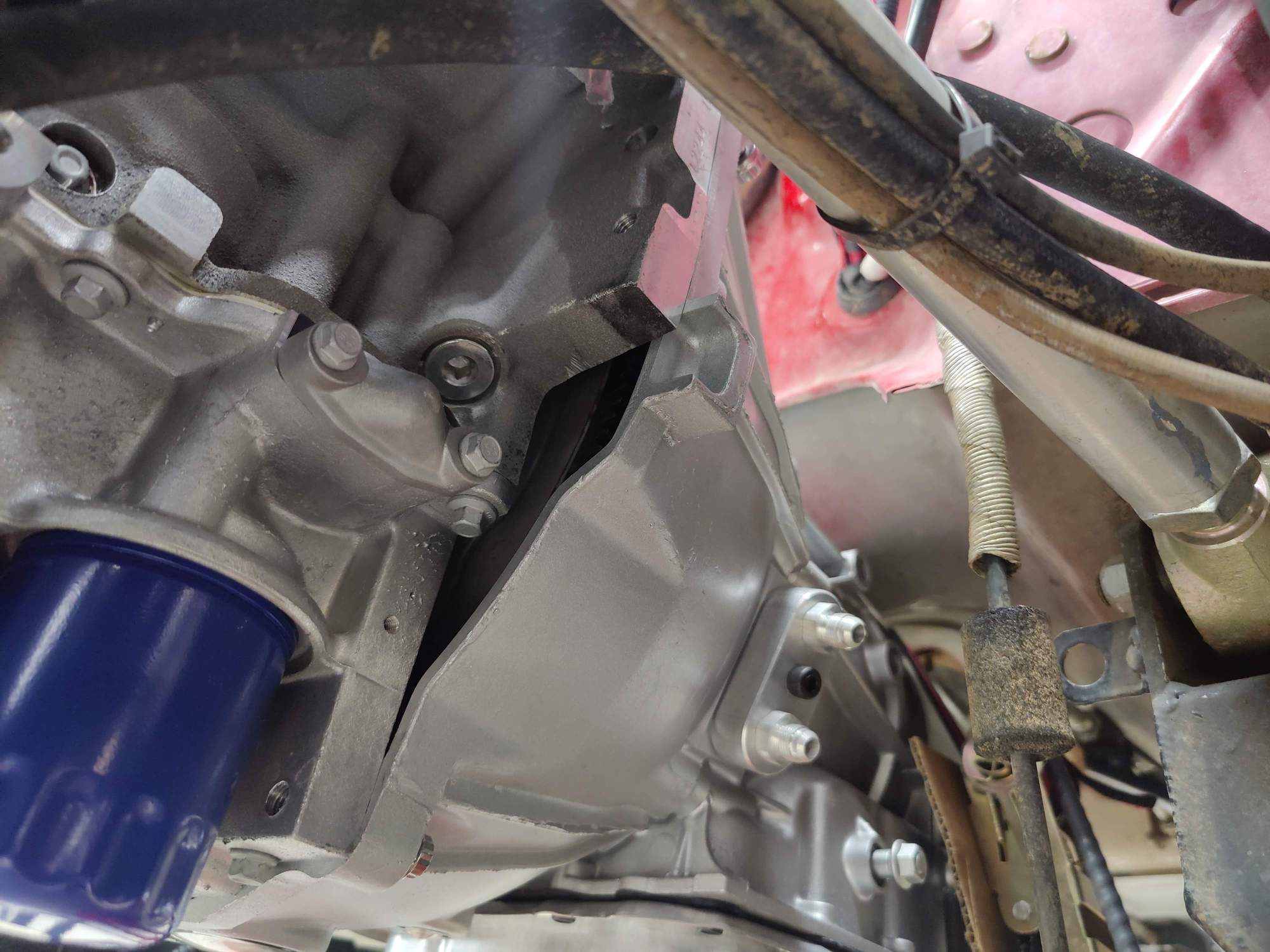

Is there a cover or plate that is supposed to fill the gap between the engine and transmission? Specifically I have an LS3 and 6L80e. There's also a gap at the bottom and other side near the starter.

Little plastic flaps. see the little threaded hole in the middle? a 10mm head bolt goes there that holds the flaps in place.

Right, it's just a little black plastic thing, gets held on by that little bolt that goes in the hole right behind the oil filter flange. One on each side if memory serves.

available on line mine were listed under something like 4L60e converter cover, think I got them from rock auto..
was like 12 bucks for both sides..
