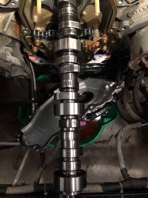

Hi All, long time listener, first time caller. I've been working on a cam swap in an L94 in a 2012 Yukon XL Denali. 117K miles on the original cam, no issues with noises or oil pressure beforehand. Swapped in the new cam with matched lifters, springs, pushrods and seals: Gross lift: 578/587, Duration: 213/222, Lobe separation 115, +3 advance. I also replaced the valley cover with the GM DoD delete flat valley cover and put a new (correct) o-ring in the pickup tube, but left the stock HV oil pump in place. Used Permatex assembly lube and cranked it over without fuel or fire for 30 seconds until I got oil pressure, and fired it up. Ran it for a couple of hours total over a couple of days and it made great power, but the oil pressure stayed at 15 indicated at hot idle and 30-35 at 2000 on the highway. The normal new cam valve train clatter diminished but the engine developed a loud chirping/clacking for the last run before I shut it down and pulled the cam to see what was going on. The cam showed classic signs of oil starvation (pics attached). My best guess is that I either nicked the pickup tube o-ring when I put it in, or didn't get it seated right and the pump was sucking an air/oil mix.
I'm planning to drop the oil pan again and replace the oil pump with a new Melling 395HV, keeping the 70 psi bypass spring it comes with in place. I'll replace the pressure relief valve in the oil pan as well.
My question for you: do you think it's okay to run this cam and lifters as is, or should I swap it all out with a new parts? What's your opinion of the damage? About half of the lobes have enough of a ridge where the lifters run to catch a fingernail, but still look pretty good to the eye. One has a slightly deeper gouge, as you can see in the pics.

Hi All, update here. I've been working with Roger Vinci on this (Vinci High Performance) and I've never experienced such great support in automotive that I can remember. He's been a great consultant every step of the way, and thinks that one gouge may be deep enough to have gone through the hardened layer. He's asked me to send it back for inspection. He's also offered to warranty it out, which means a regrind or a new cam, even though neither of us believe his parts were at fault. THAT's service. He's out of lifters though so I'll likely get new LS7 style lifters from Summit. I'll stick around here though and try to help out others as I can. Hard to expect help on any forum when I haven't first given help to others.

You need to look at the lifters.

Thank you, I agree. I'll have them out this weekend. Got the cam out on the bench yesterday and took a better look. The damage is much worse than I initially thought, with more than half of the lobes exhibiting significant scars and even some spalling on the ramp. Again, oil pressure was lower than I'd like but not zero (15-20 psi indicated at hot idle, 35 psi on the highway.), and the cam was dripping with oil when I removed it, so I'm shocked at seeing so much damage after less than 2 hours of total running time.
Roger Vinci has kindly agreed to take the cam in for further analysis and offered warranty support. He's been fabulous to work with through this whole episode. Will hopefully know more in a couple of weeks but will report back on the lifters in a couple of days.
