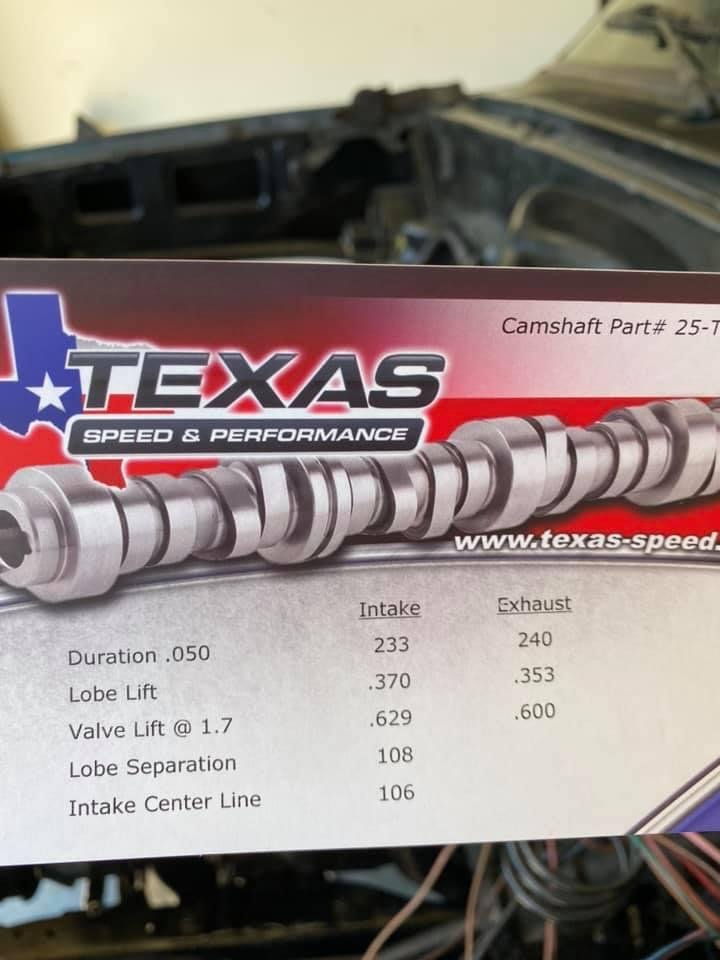

This is supposed to be the 6.0L version of the BFD.
Old Apr 16, 2021 | 10:50 AM
Posts: 22,299
Likes: 3,619
108 LSA?? Whoa. That would shake and lope like a dog... uh.... expelling peach seeds!
