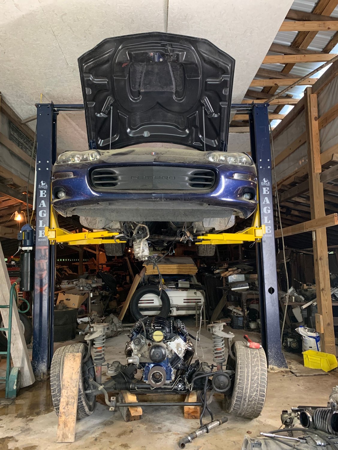

Started this build in February as a complete rebuild of my h/c 6.0L and just got it put back in the car and finished beside injectors.
LQ4 Block bored .040” over
LQ4 Crankshaft
Summit Pro LS flat tops with h-beam rods
MS4 Cam
Hand ported 862 heads with 2in intake valves
Dorman LS2 intake with a 92mm tb
1 7/8” Lt’s basically straight piped exhaust from previous owner
11.3-11.6 to 1 CR
etc
My goal was to build a stout na motor that could make up to or at 500whp. I plan on going nitrous or boosted later on so rings have already been gapped. I’ll try to keep this thread up to date on dyno numbers and track times it actually puts down for anyone interested. This is my first LS full rebuild so I’m really interested to see how it performs. Before it made 402whp and 387ft-lb on sbe with the same cam and heads and a LS1 intake with stock 22lb injectors.
Spun #3 rod bearing
Pumped oil pan dry
Carnage
Head porting
First assembly
Head studs because why not
Had cam degreed in and short block completed

I absolutely love these DIY garage shots...
Any details on the white car behind it...???

It’s a 1968 Firebird dad picked up years ago and passed it down to me to restore because he never had the time to. I’ve started on it one time but haven’t gone back to it since I started building my Camaro. Needs some love has about 4 different layers on paint and bondo in some areas but the interior is almost perfect just missing some small pieces would like to turn it into a show piece at some point.
