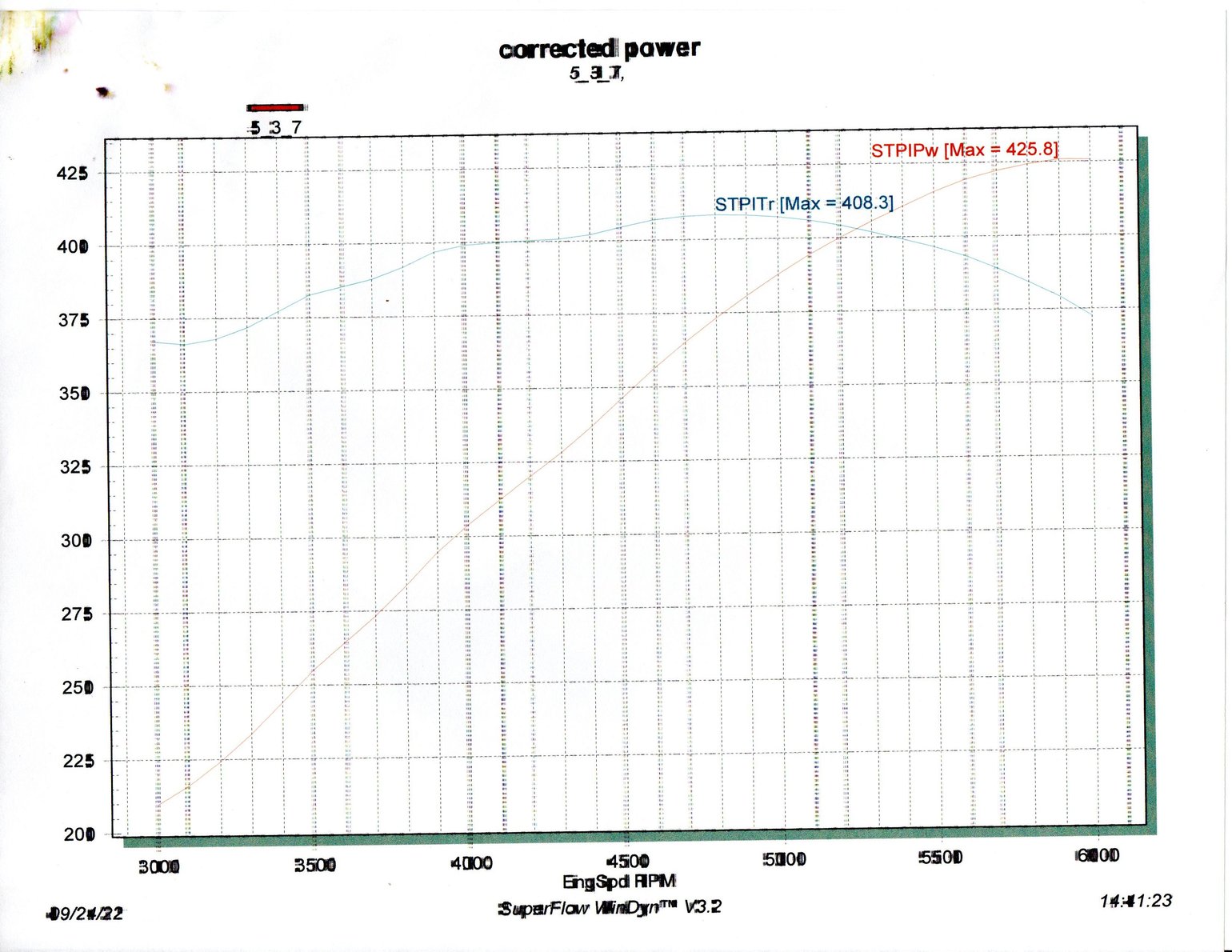

I recently built a Gen-4 5.3L similar to what you are wanting. It started as an LMG (flat top pistons). It didn't have heads (799/243) when I bought it, so I put some 706 heads on it. I used a BTR stage-2 truck cam, and did the DoD delete. With stock intake and exhaust manifolds, it made 425hp / 408tq on an engine dyno. I wish I had headers to run on it. Headers probably would have added 10-15hp and torque.
I wouldn't buy "rebuilt" heads online or from any shop. It's too easy to "rebuild" heads yourself. You can replace the springs and seals yourself. I ported mine a little, but it's not necessary. Just find some junk yard heads, and clean them up. I have bought two sets of 706 heads off of Facebook Marketplace. Your local junk yard could also be a good source. You should be able to get a set of 706/862 heads for about $100-$150.
There was talk about octane and compression in an older post on this thread. The engine I built has about 10.7:1 static compression with the flat-top pistons and lightly milled 706 heads (61cc). The engine dyno guy said he used Mid-grade fuel from the local gas station (out in the hills). At best, the gas might be 89 octane. I wouldn't recommend trying to run Regular (87 octane) gas with this much compression, but anything else seems to be fine.

I'm not sure which cam you were looking at, but here's what the BTR stage-2 truck cam does on a 5.3L. More or less cam duration will move the curve one way or the other.

In that RPM range, you won't be anywhere near 400hp. My 5.3L started making 400 ft. lbs around 4000 RPMs, so that goal is possible. Take a closer look at my dyno chart if you want to have a better idea of HP/Tq numbers that you would be working with in your listed RPM range.
