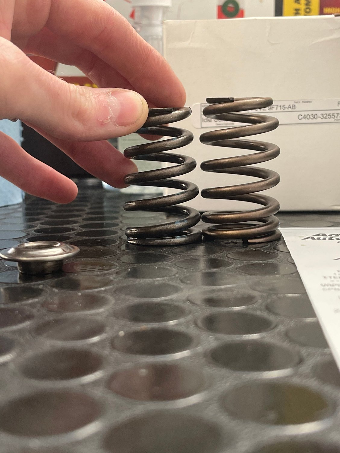

Old Dec 24, 2021 | 01:23 PM
cjstone's Avatar
Joined: Dec 2021
Posts: 10
I’m not seeing anything broken there?
anyway, a lot of **** springs on the market.
If real PAC 1219’s, they will be fine.
The one on the left is one of the unbroken ones. When I get back home I’ll snap a few of the broken ones
Old Dec 24, 2021 | 01:30 PM
RonSSNova's Avatar
Joined: Aug 2011
Posts: 4,734
Likes: 815
From: Portland, OR
Cool, thanks.
a buddy had multiple **** springs break, Amazon kits. White box stuff. And the cam was only .550” lift.
FWIW, the BTR platinum is an excellent spring.
Hope you get it back to the dyno!
