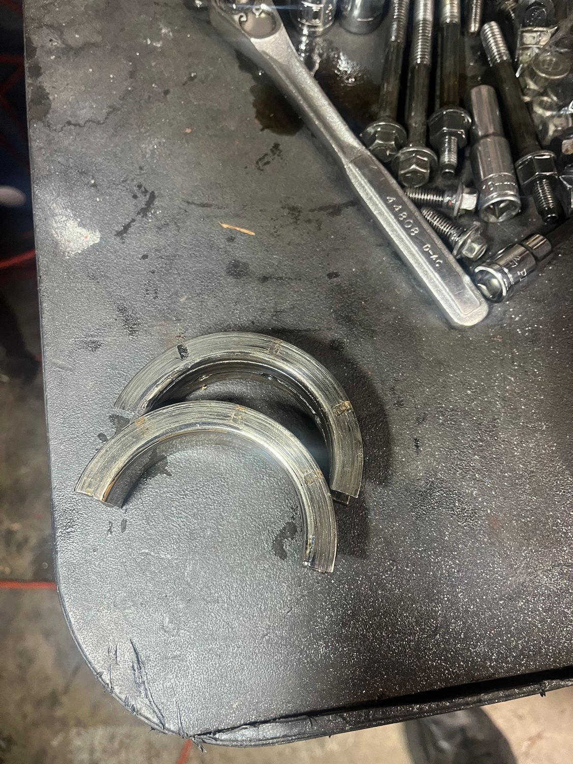

Well, it’s apart and it’s not good. It blued the crank. Thrust destroyed of course. Unfortunately the thrust bearing spun in the block. Maybe a turn or two.
My guess here is that the converter hub to crank spacer that is typically used was bound up from the get go, constantly pushing on the thrust. That’s a tricky area if you aren’t familiar with the required spacing.
I haven’t seen the parts in person yet.

Any idea on what flexplate and spacer was used?

Along with a curved flexplate

Instead of these stupid adapter rings, there are a few variations in length, I think it’s best to get a torque converter with the proper LS hub.
I did this to mine and eliminated that adapter. Truckdoug machined this up for me.
I should have just had PTC put the correct hub on from the start.

Well, the crank is toast. Every crank throw hit the block. Block is salvageable. I found him a nice Gen 4 5.3 crank.
