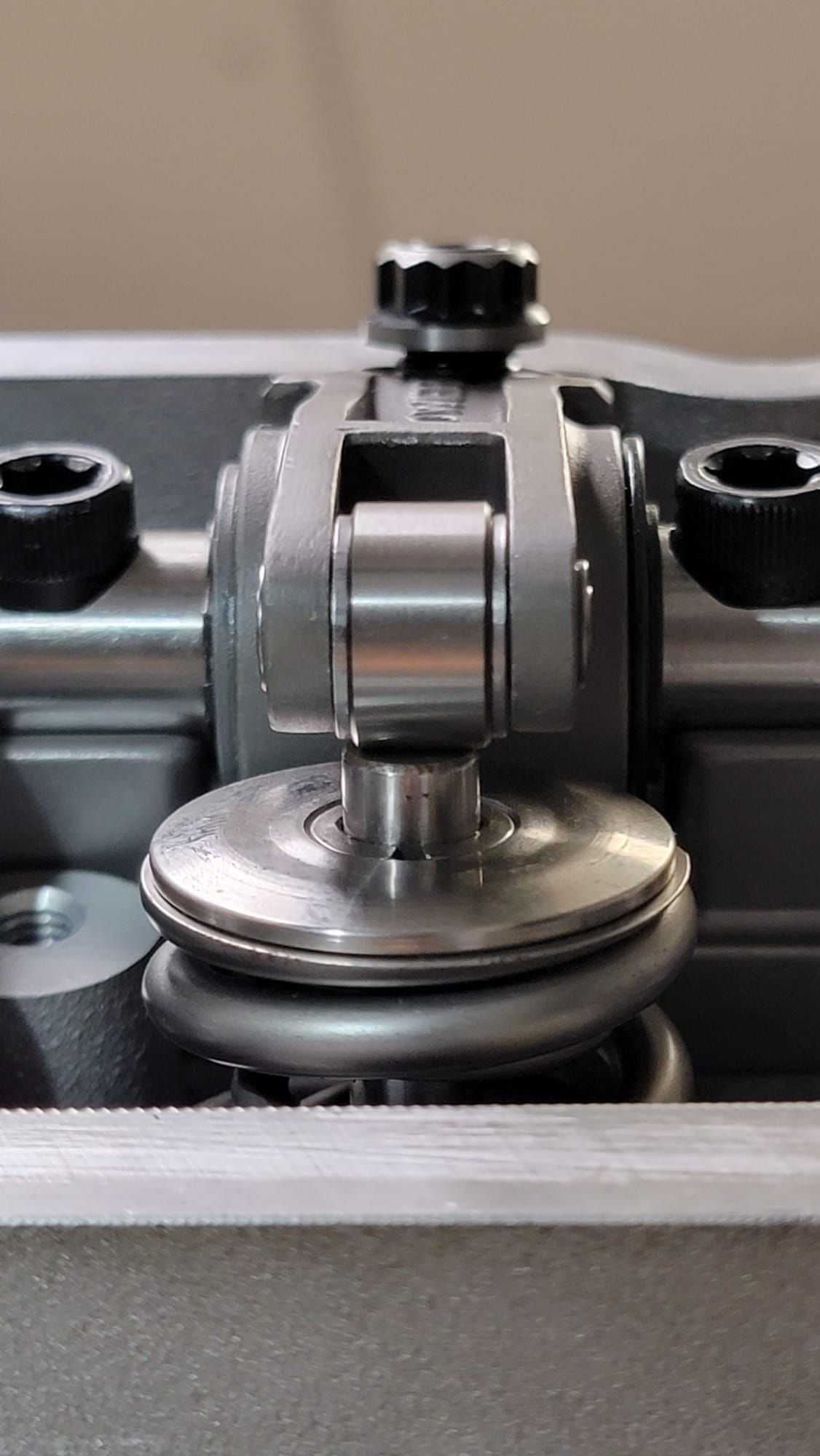

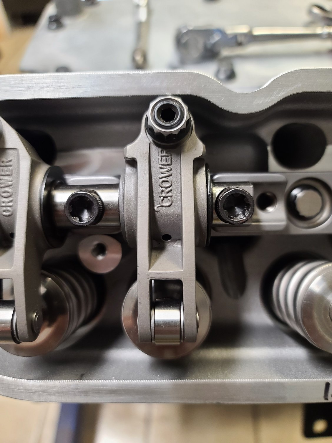

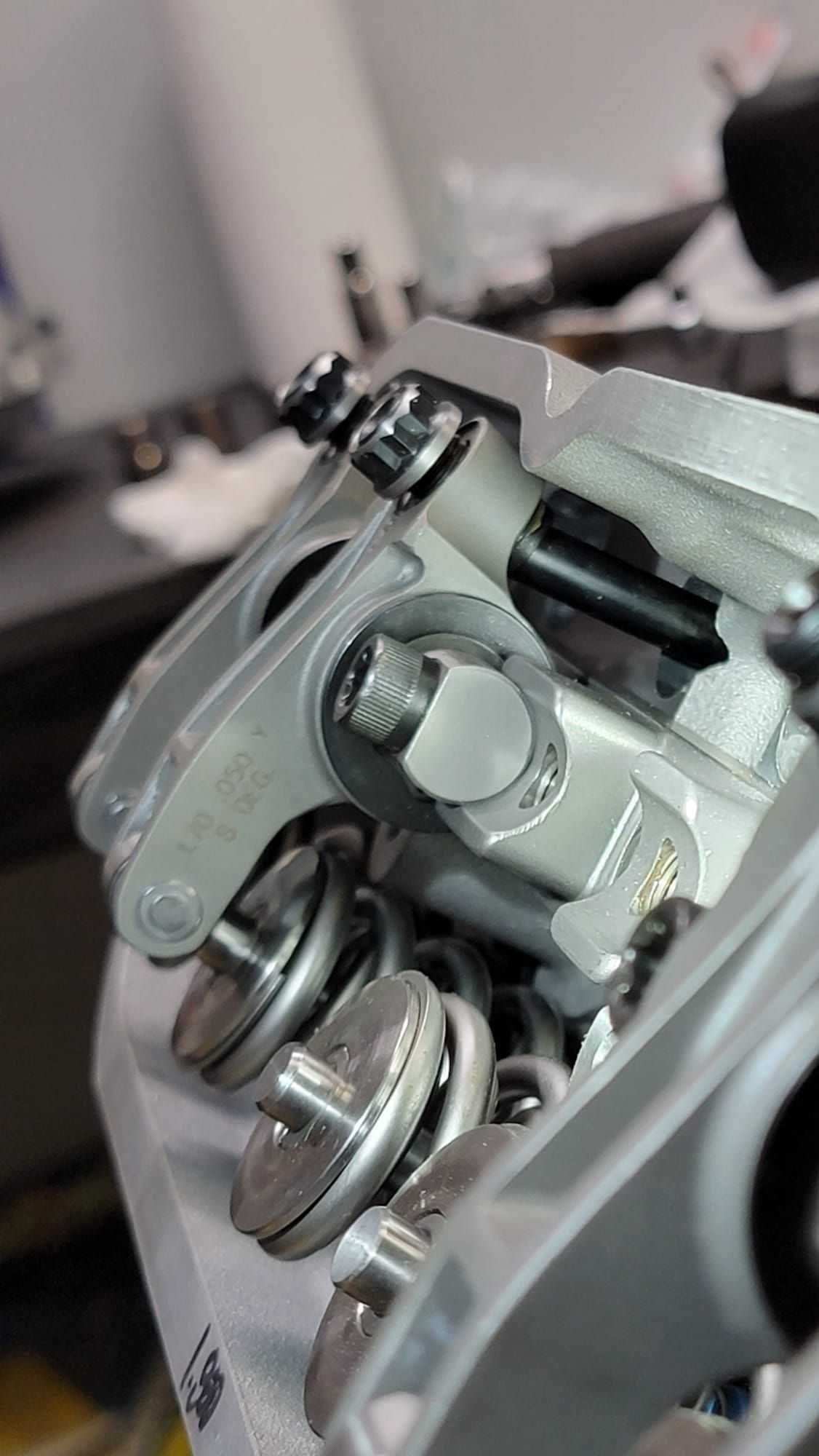

Hey guys just looking for some advice from you'll more experience builders. Well I bought a whole setup from a member on here and this ls3 aftermarket heads (liberty 11° I believe) came with the Crower shaft rockers but I didn't get any of the tools and shims for them, will be calling Crower to order what I need, just looking for thoughts on how this looks, thanks in advance 🙏

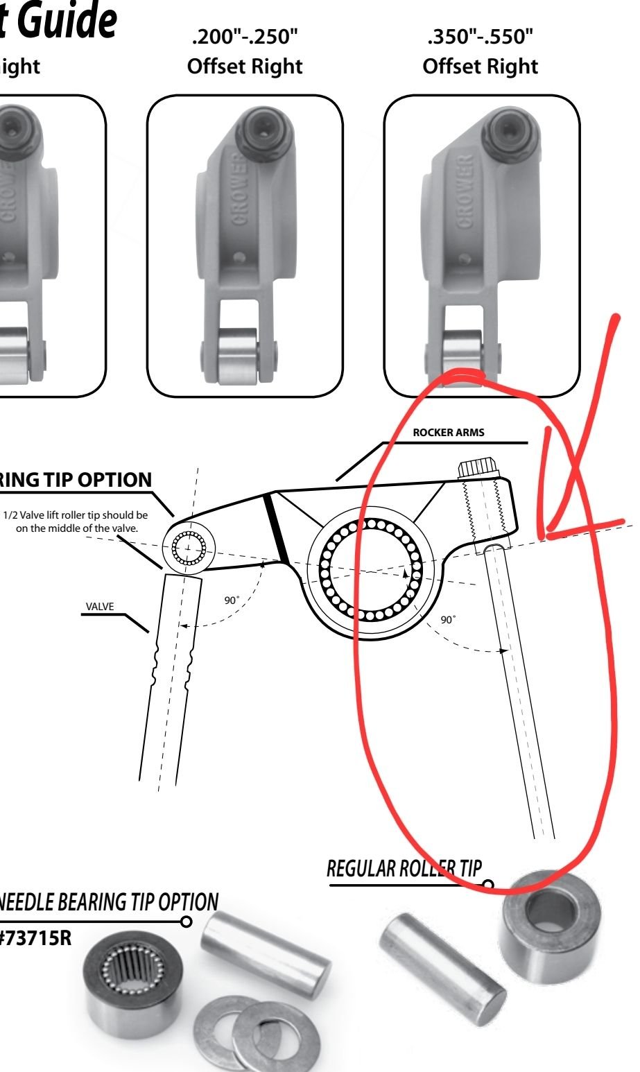

Yes adjuster at 1 to 1.5 turn down and measure, but I don't like how the angle of the pushrod to rocker arm looks BTW Cam lift its a bit less then .750

In regards to your concern about the pushrod angle, I'm assuming you got it figured out? However, if anyone else is reading this, the diagram shows the rocker at 1/2 lift, and the OP's photo shows the rocker at rest. They want the pushrod angle at 1/2 lift to be 90* and the roller to be centered on the valve tip. It's normal for there to be that kind of angle on the pushrod when at rest.
Yes. Pushrod should be 90 degrees to rocker body at mid-lift, and roller/pad centered on valve tip.
