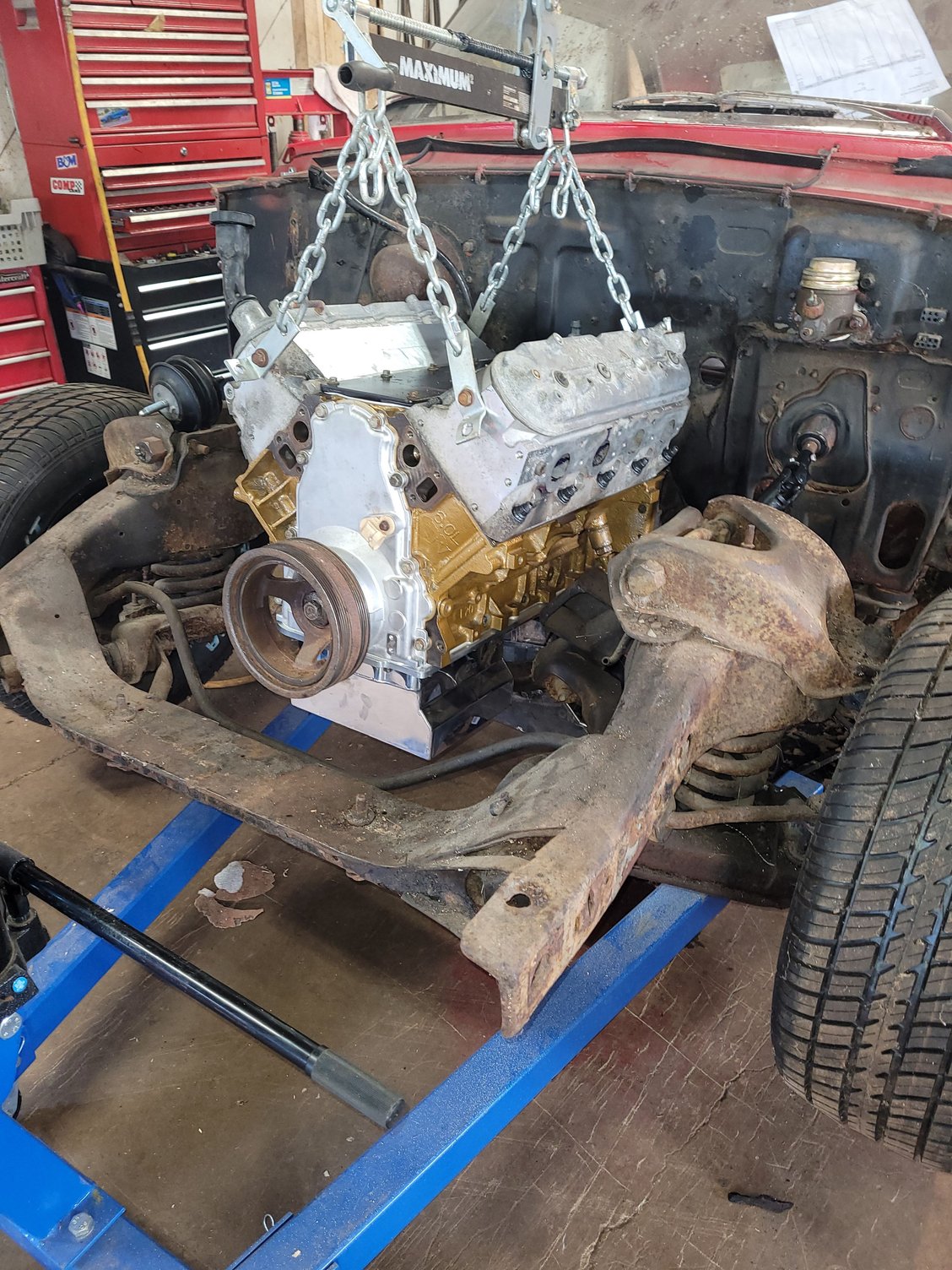

Sooooo ,I'm now showing my age .I just rebuild my first LS , an LY6 and realized I forgot to bolt down the lifter trays. I'm pretty sure I know the answer, but does it have to come apart again ?

Yikes. We're all human and make mistakes. Have you run the engine?
Heads must come off to get to the lifter trays.

No I haven't run it.its just sitting in the hole for mockup , no trouble to pull the heads. Just glad I remembered now.

Indeed!! An hour or two now, or several months and big$$$ later!

I definitely would go back and put them in. I bet it wouldn't take long for the a lifter to turn and start chewing up the cam.

Are you sure you left them out? Maybe reused old ones?
I just looked around mine to see if they're visible and they are through the head bolt access hole.
