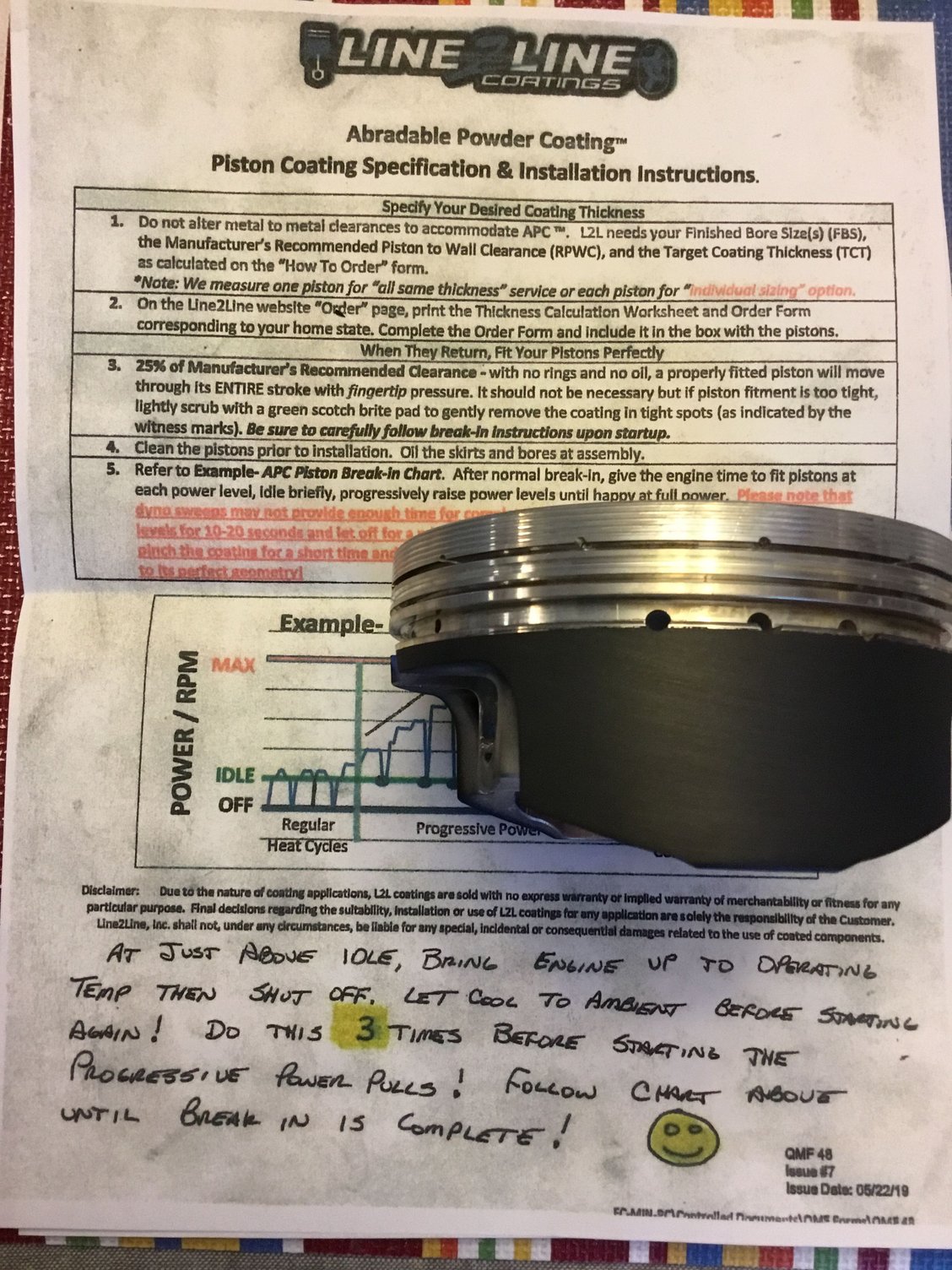

If you just need a couple thousands clean up you could go this route
