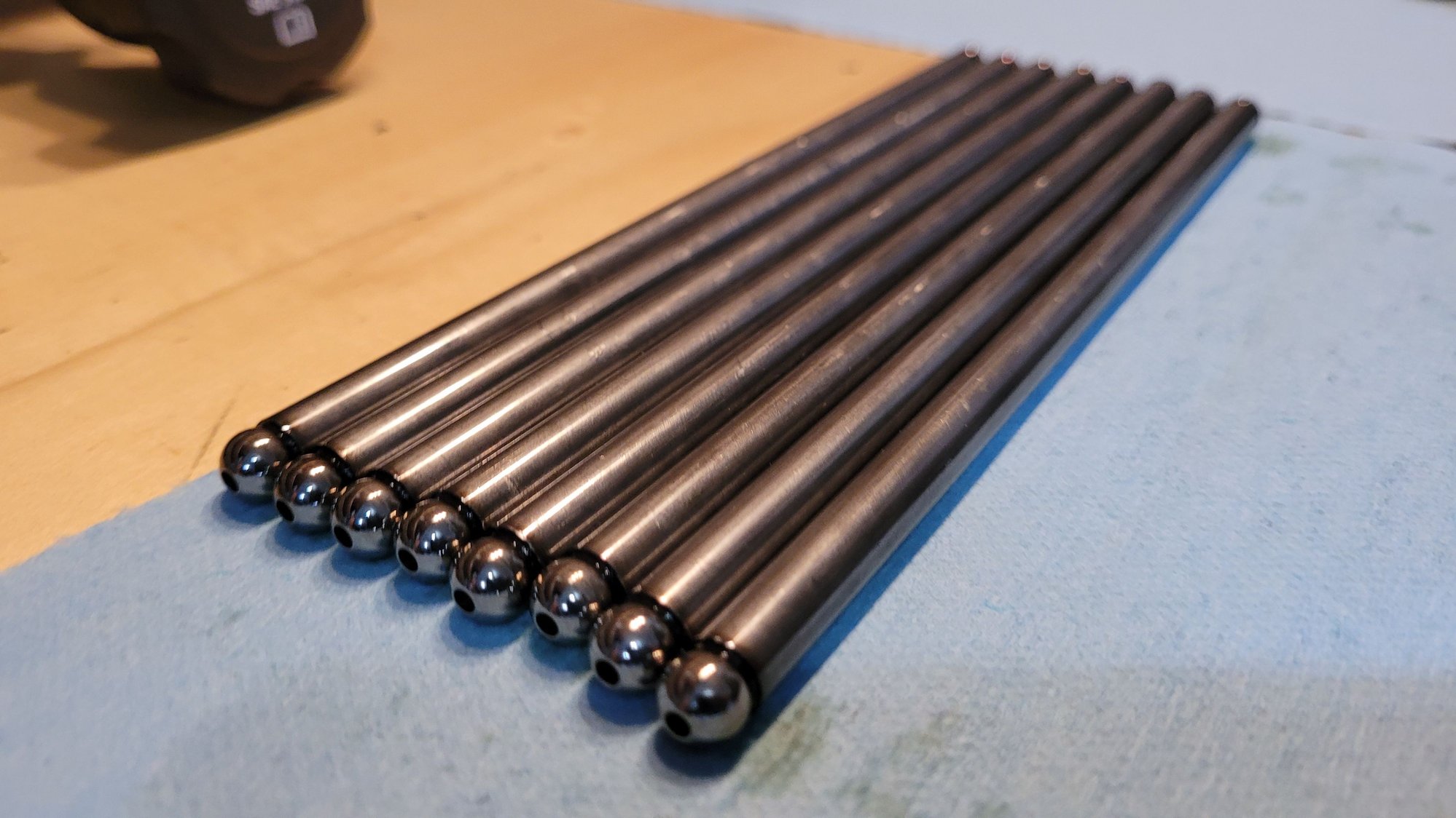

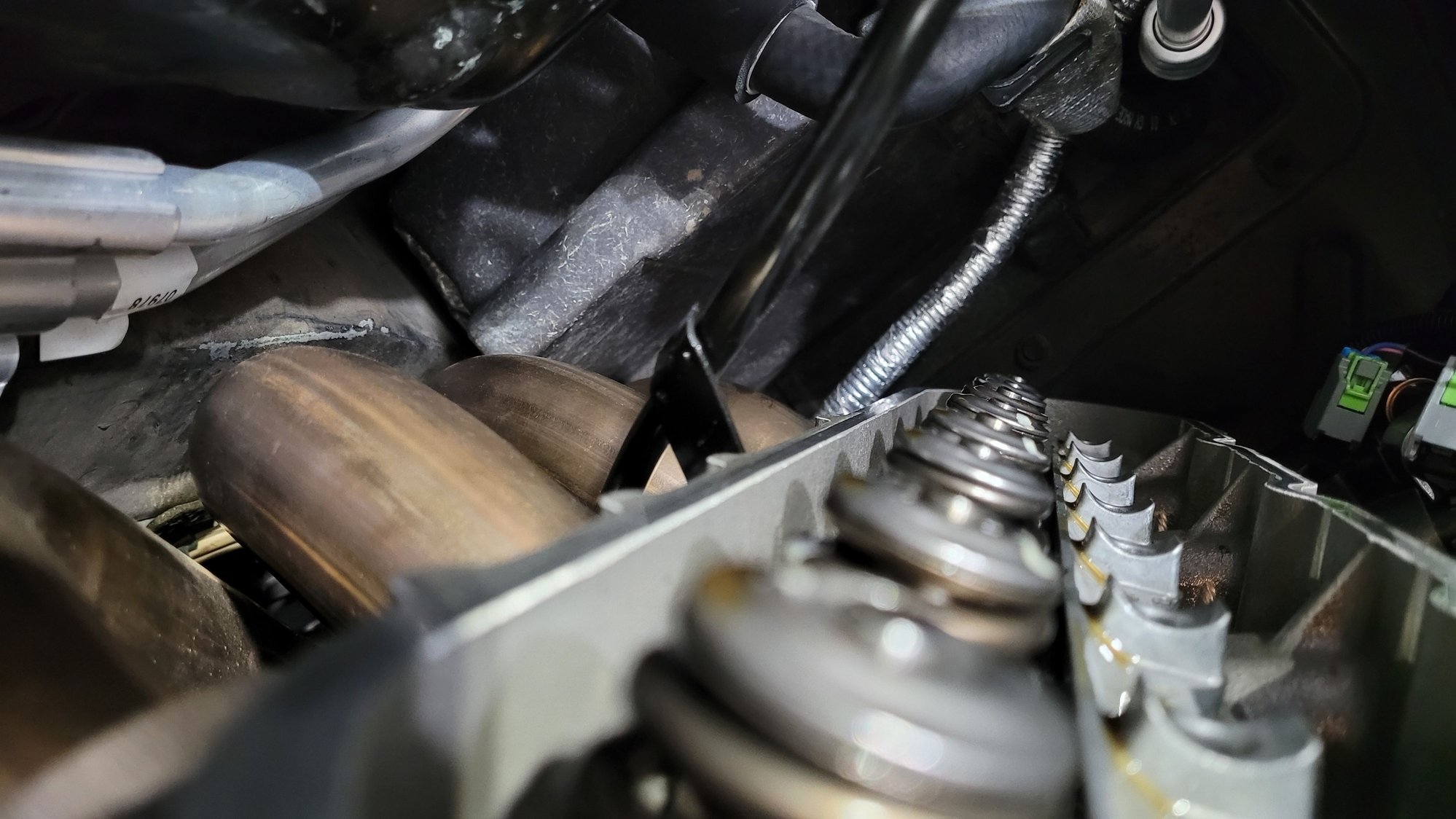

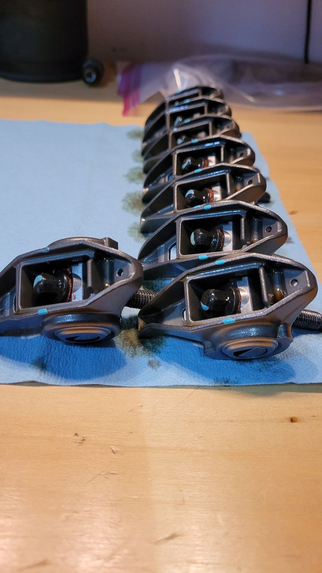

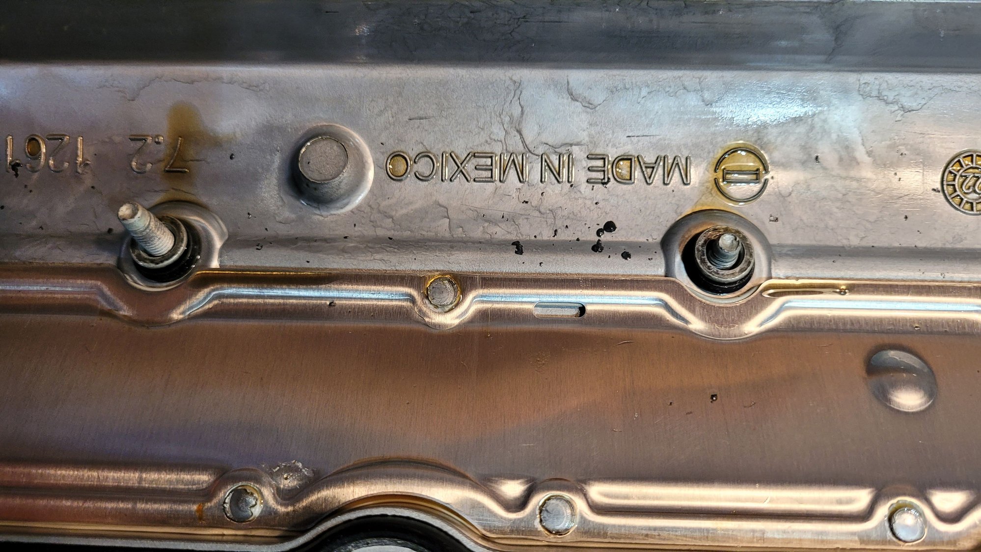

Inspected the pushrods, all still straight. No broken springs, no compressed springs, no broken rockers. I did see some tiny specs on the inside of the valve covers that looked and squished like anti seize. Maybe leftover assembly material? I want to check for bent valves tomorrow. Would it be better to do compression tests or leak down tests?
