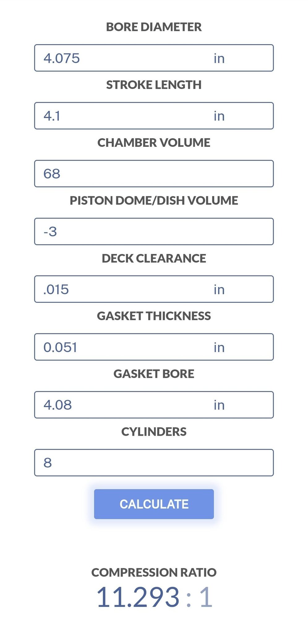

I'm going to be building an LS3. My plan is to bore it out .010"and use a 4.1" stroke crank for 428 cubic inches. What is the maximum safe compression ratio? I'm an old cast iron guy where we tried to keep it under 9.5:1, 10.5 with aluminum heads. These were old, non computerized motors. I know that the aluminum head with an aluminum Block and computerized control, you can go much higher. How high is high. I've searched and not found what I'm looking for. I'm trying to figure out what dish I need on the pistons.

Everything is negotiable at this point, but this is where I am in the planning stage. I was asking about the max static compression ratio to help determine the pistons to use. My math on the stroker kit tells me that with the pistons in the kit that I'm looking at (1.050 compression height) and a 6.125" long rod, the pistons will be .015" in the hole. With that, it gives me an 11.3 static compression ratio. As an old cast iron, carburetor guy (yes, I'm old), that scares the hell out of me. But with aluminum, fuel injection and computer controlled motors, I've read where some say 11.4:1 is OK.

I plugged your data above into the Wallace Racing dynamic compression ratio calculator at "http://mobile.wallaceracing.com/dynamic-cr.php".
I assumed your cam has 2 degrees of advance ground in, so the ICL is at 110. I assumed your cam has very aggressive ramps, so the delta between .006" lift and .0050" lift is only 25 degrees. This gives an intake valve closing point (at .006") of 69 ABDC, which allows a bit less static compression than softer ramps would. The 25 degree assumption is conservative in that regard.
I *assumed* you'd be at sea level ... you can get away with a bit more static compression at altitude, but you can't take road trips to the coast.
Using that as input, your dynamic compression ratio comes out to 8.76:1. Most people say 8.7:1 is about as much as you want to run on a street motor using 92 octane fuel. My engine, with 11.8:1 static compression, has a dynamic compression ratio of 8.85:1. I run it on 92 octane on the street, and when I go to a track day I add a bit of Octane booster. My car is very light, so doesn't load the engine as much. I'm also not towing with it.
I'd say you'd probably be fine with that static compression ratio and that camshaft. If it was me, I'd run it.
