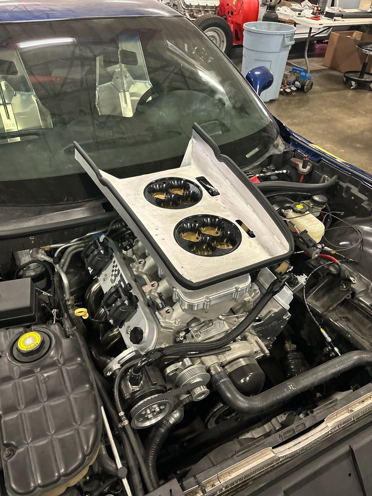

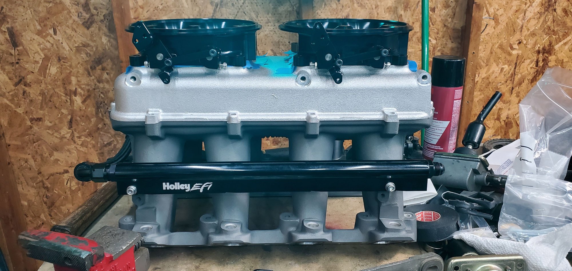

He is going to do this with a Hi Ram. (Mine and jayyyw are low rams, posted mine below the hi ram pic).

Old Jan 3, 2025 | 11:28 AM
  #33
DualQuadDave's Avatar
Joined: Feb 2014
Posts: 1,850
Likes: 619
Winner, winner- Chicken Dinner🤘🤘
