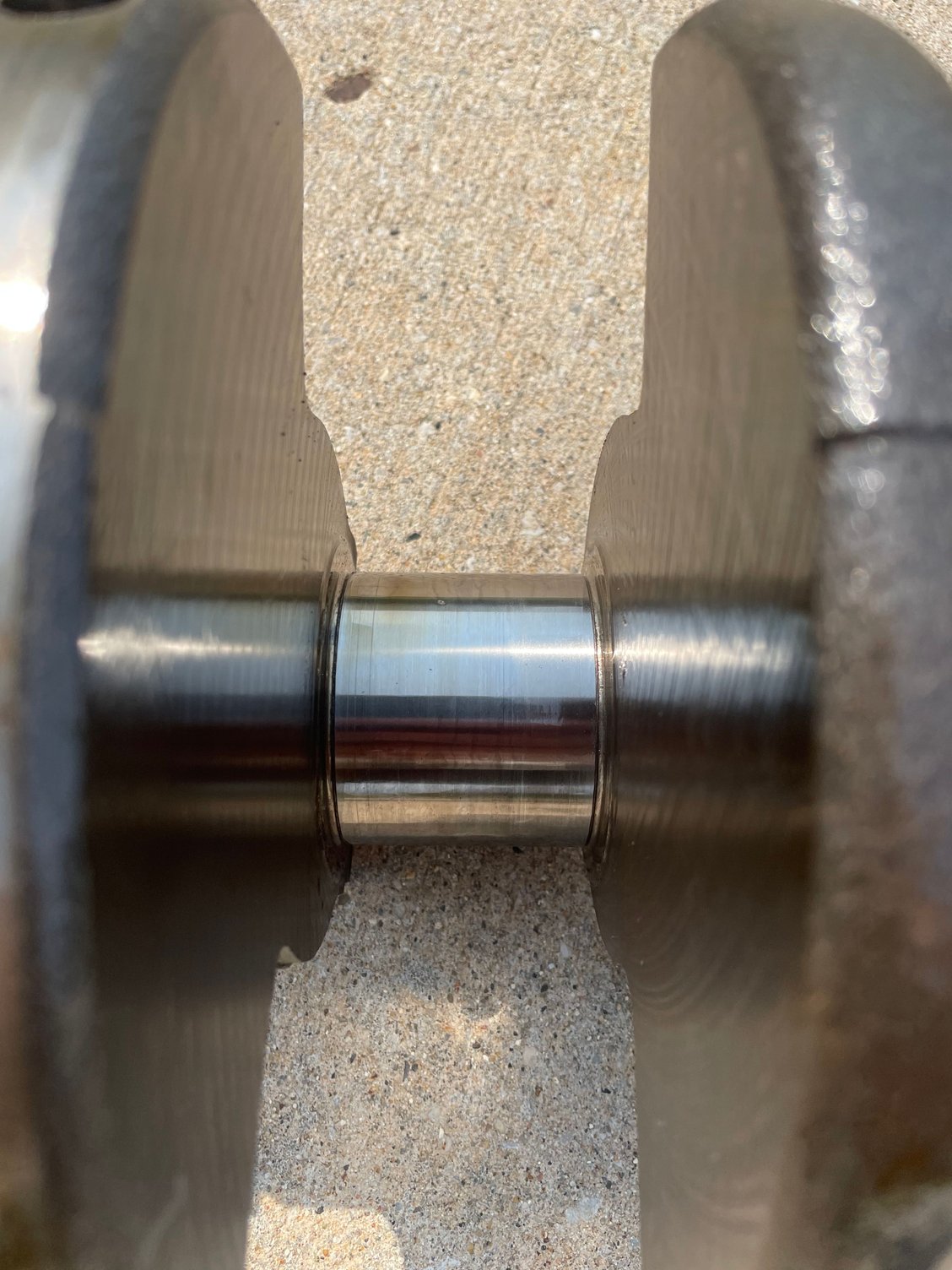

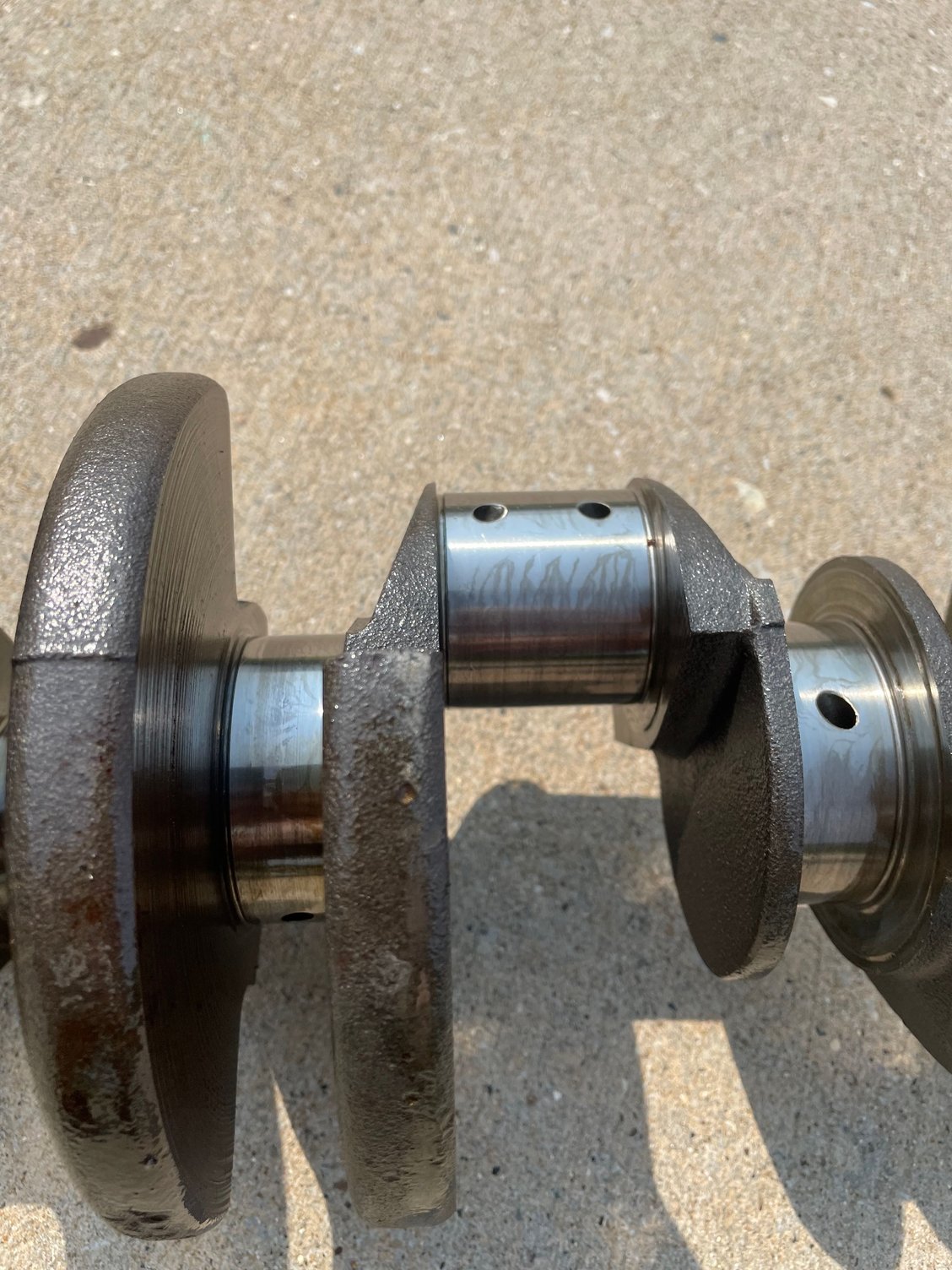

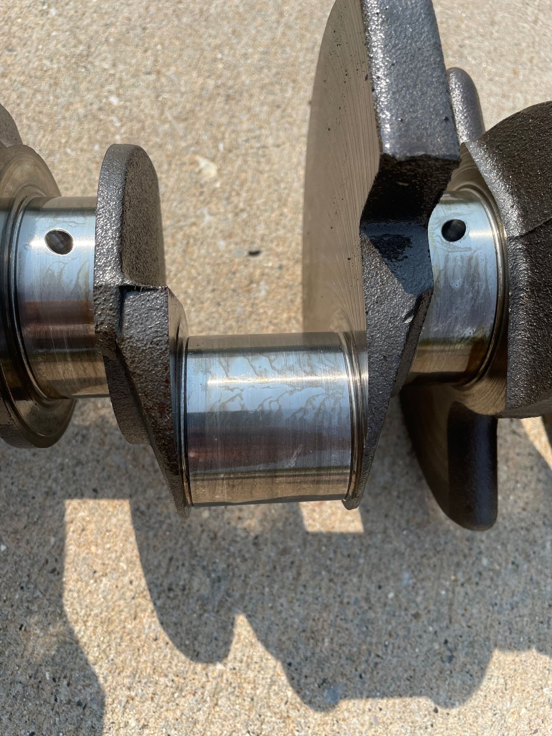

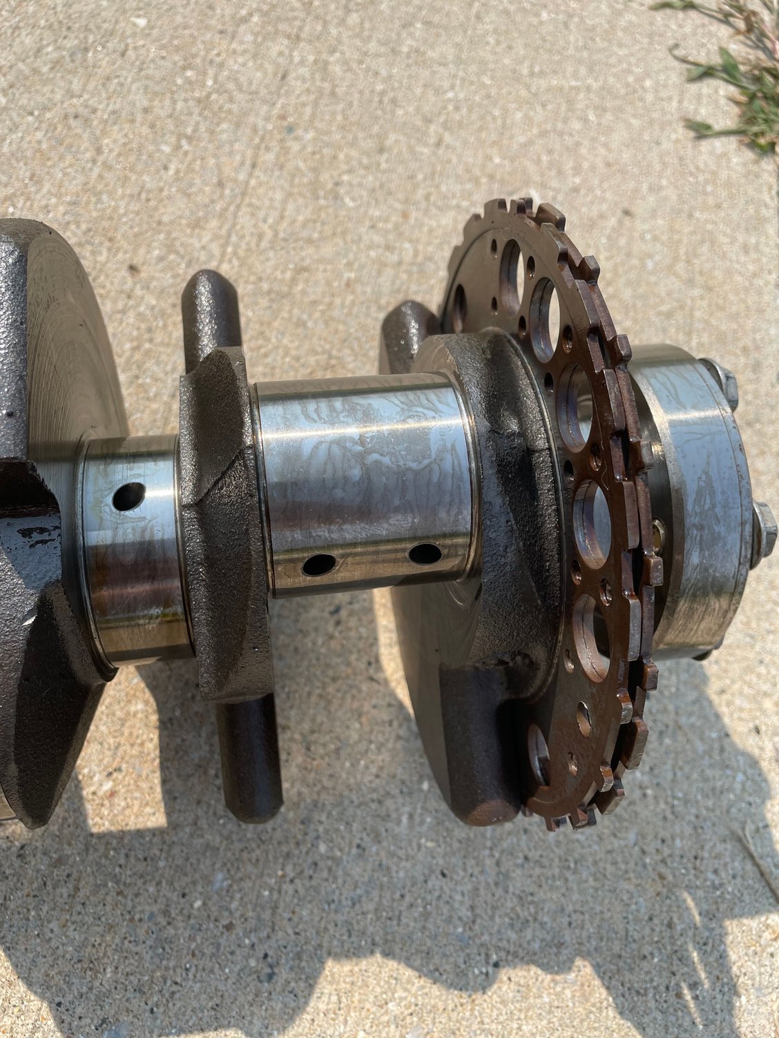

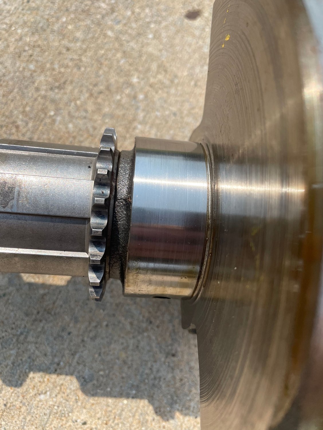

This engine has sat for nearly a decade and my crank looks like this. Is it even good ? Main bearings are stamped .020 and rods are .010 . I plan to make about 700whp after it’s put back together. Will this crank survive if it’s ground down/polished again ? What opinions does everyone have?

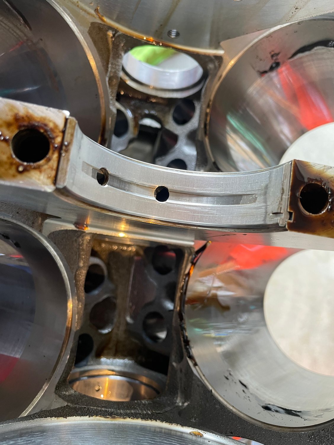

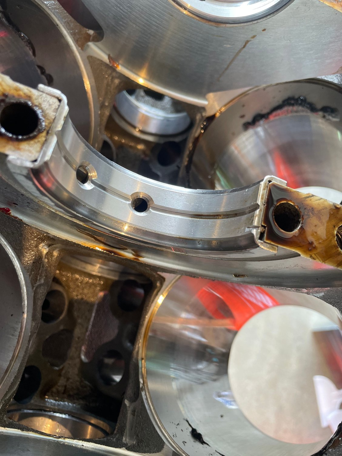

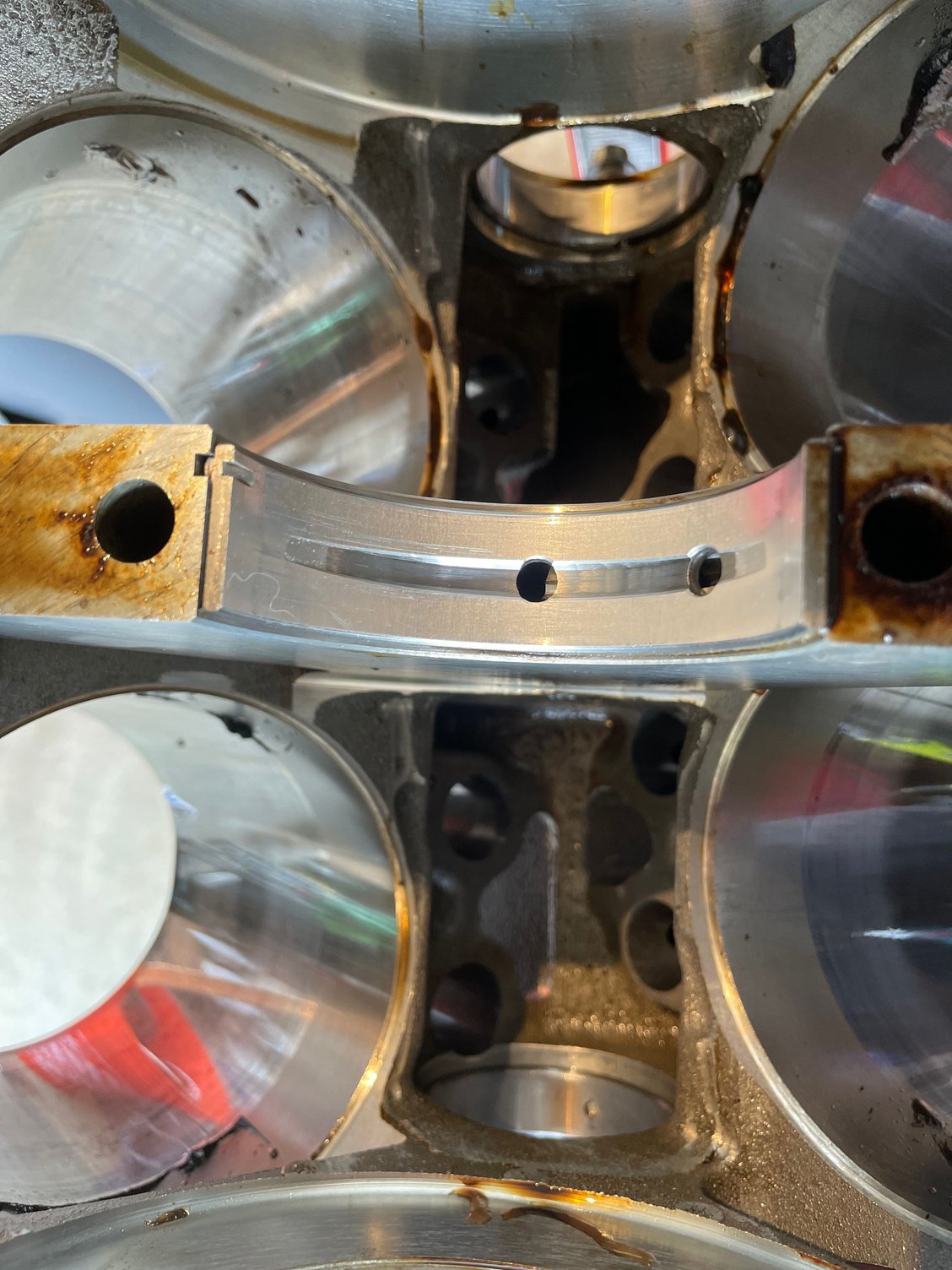

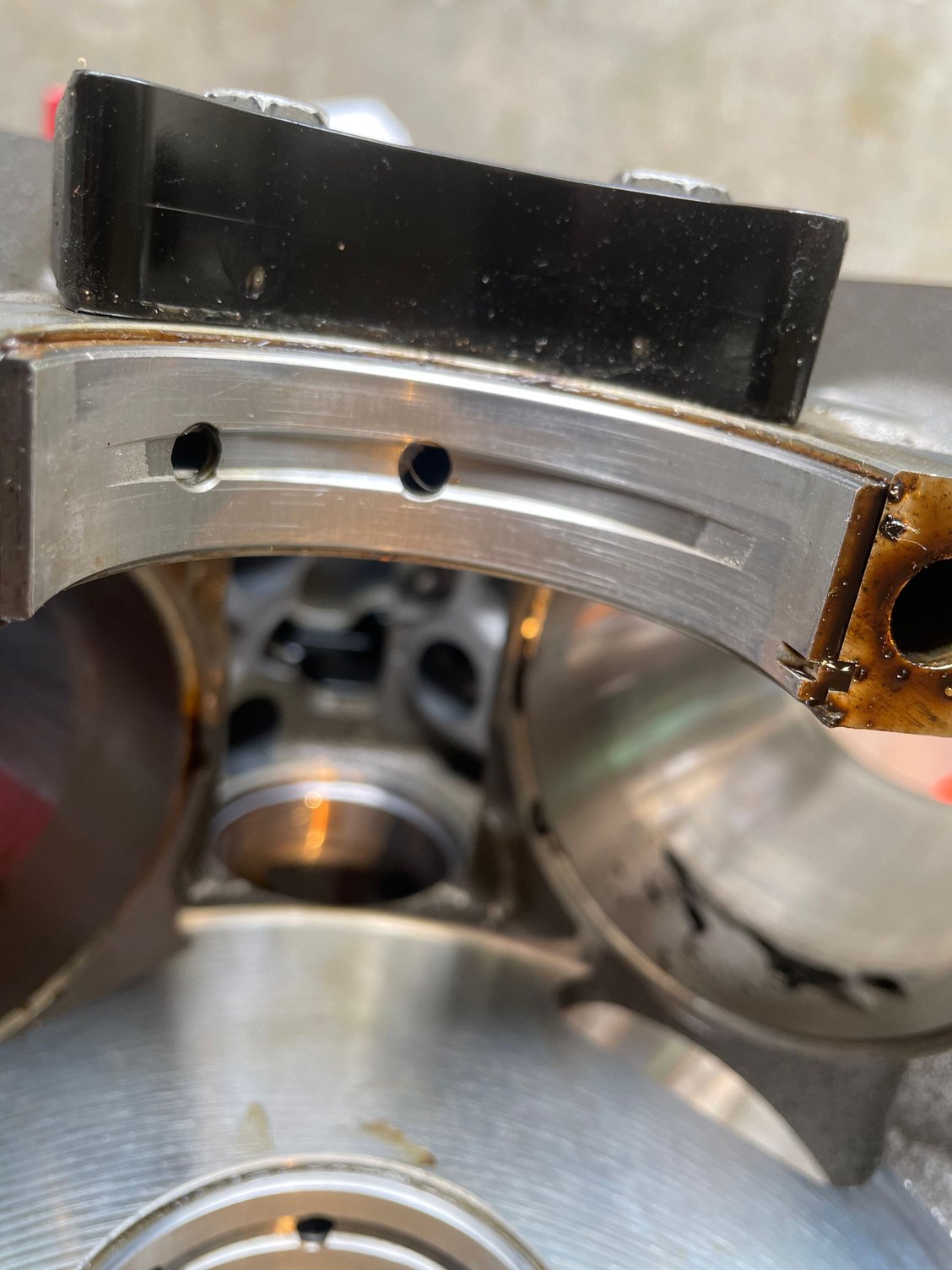

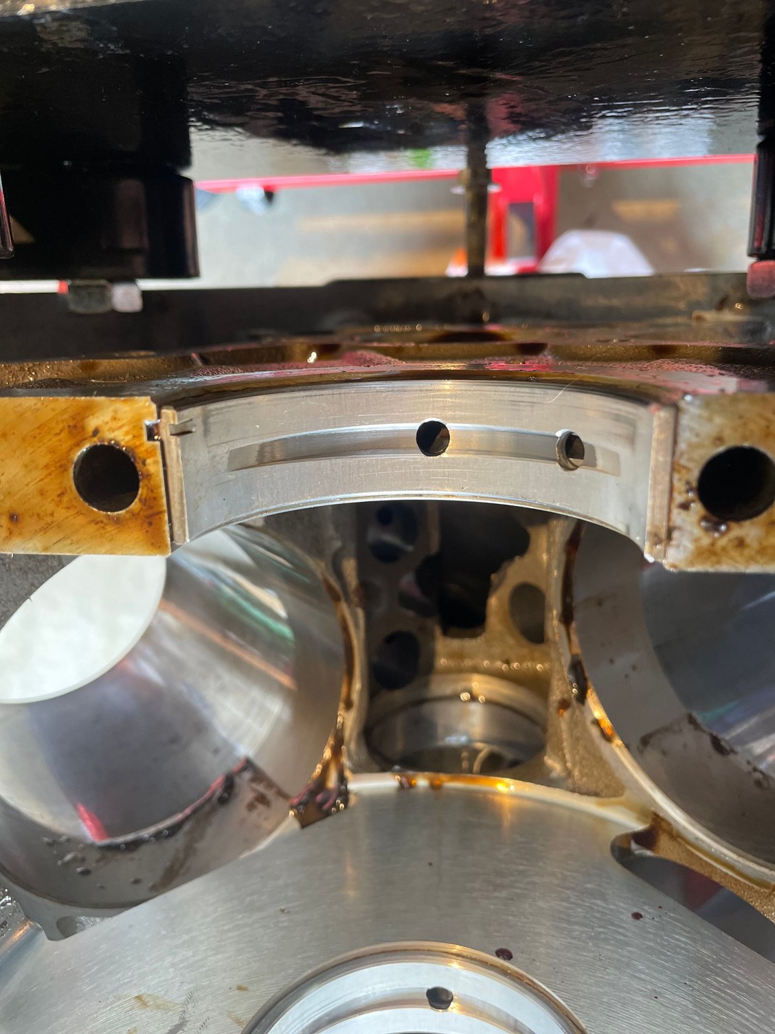

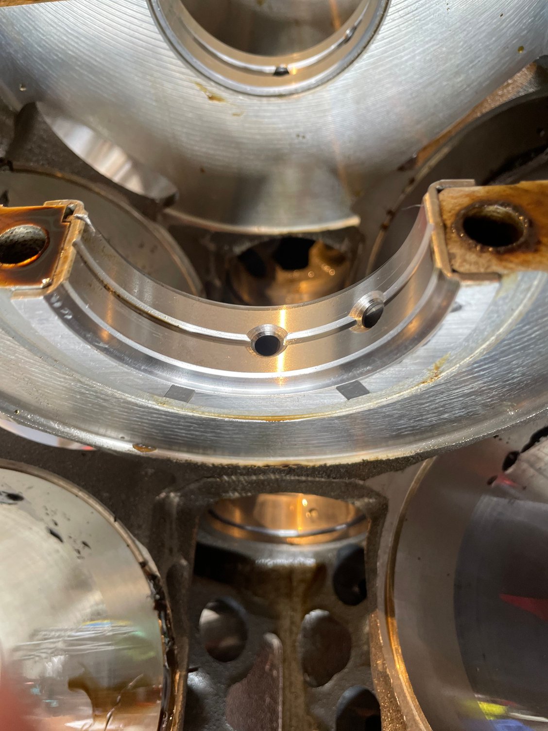

These are the main bearings on the block side

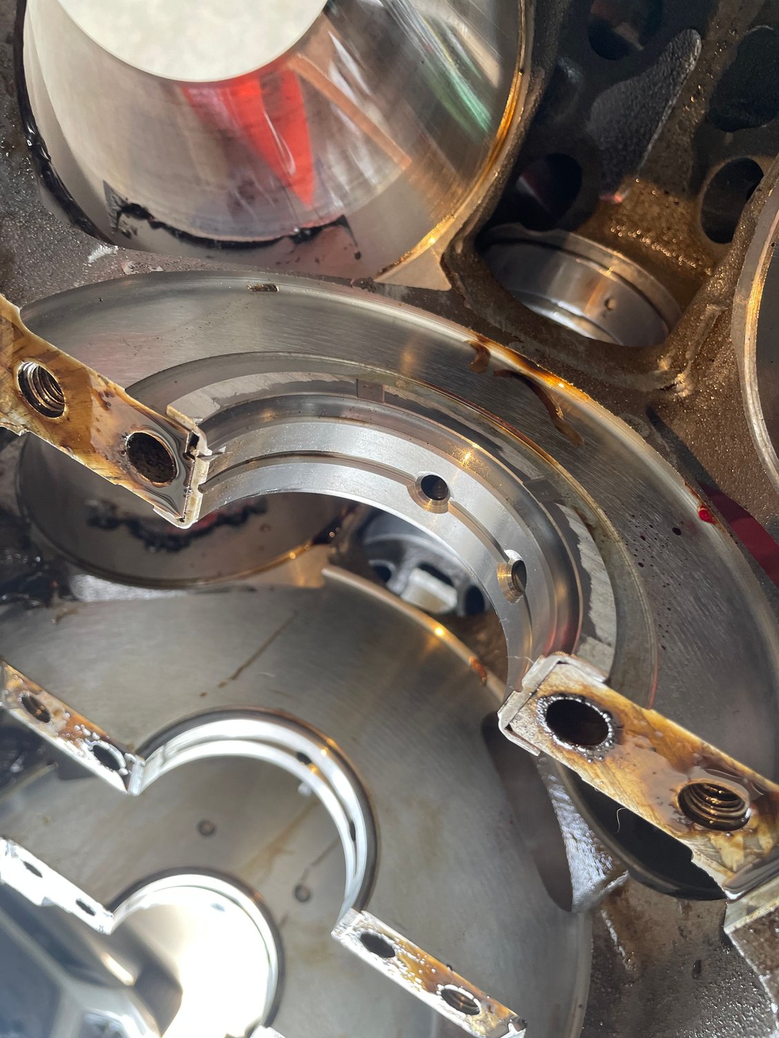

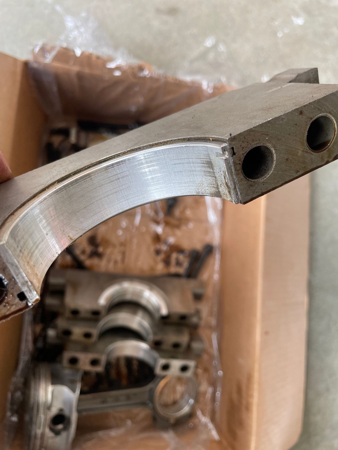

What do the main cap halves look like? They take the brunt of the forces acting on the crank.

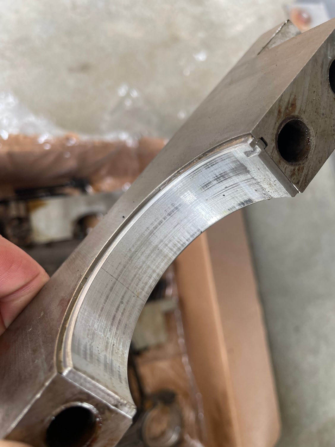

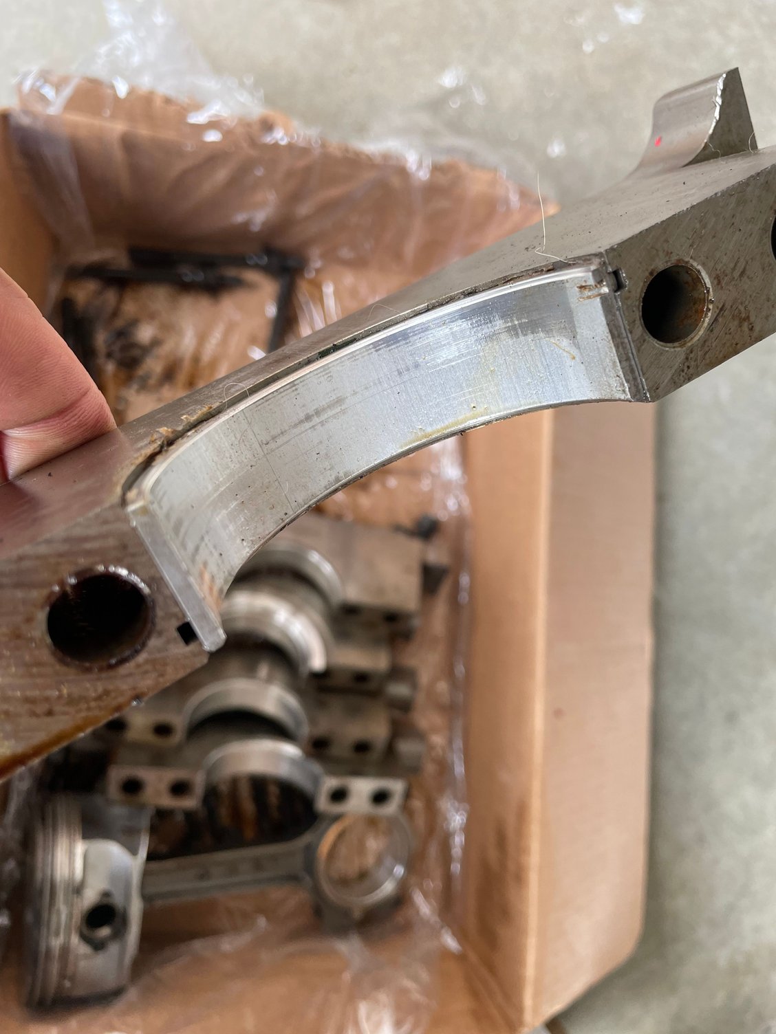

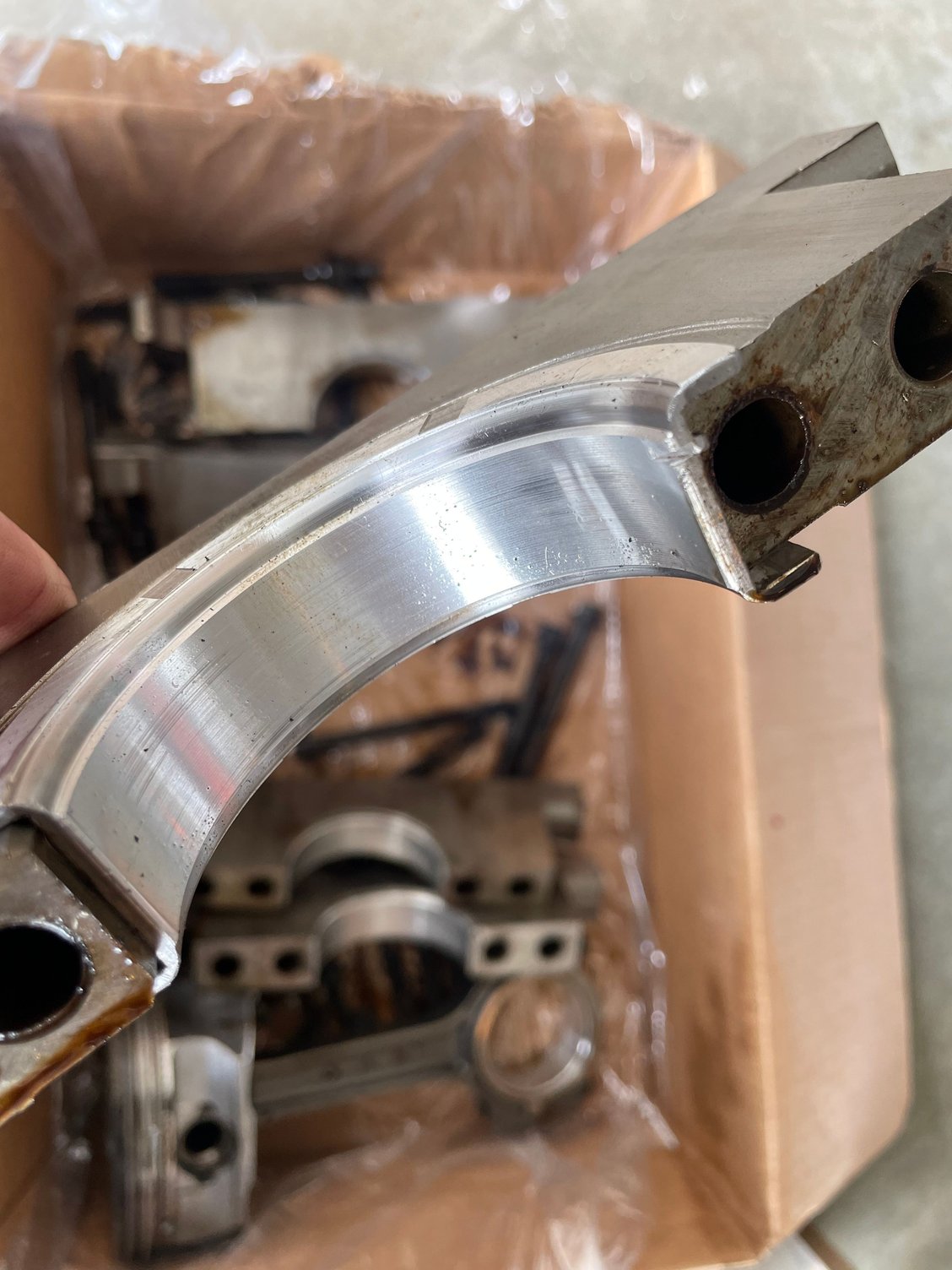

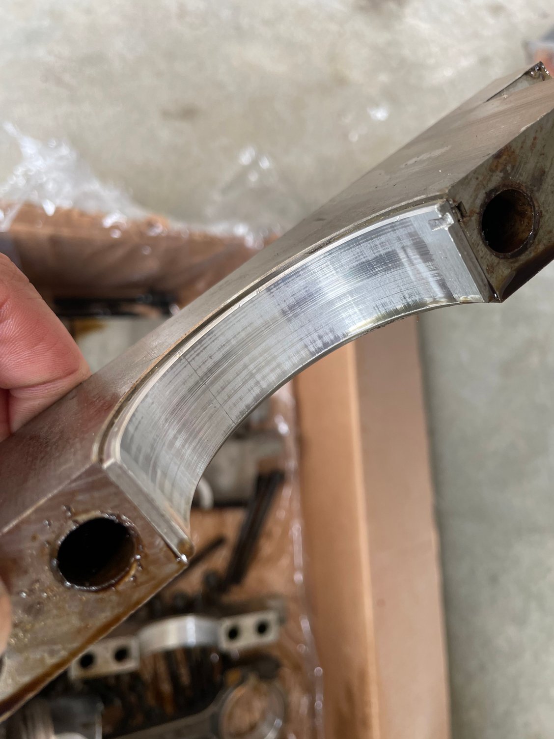

these are the main caps and they do not look pretty …. The crank doesn’t look like the cap bearings tho for some reason .

As I said, the cap bearings take far more thrust than the upper block bearings. Hence (way) more wear....
The crank is harder and won't show wear like the bearings do here.

I’ve seen guys run cranks that look much worse in a pinch. Have it polished and give it a go. No worries.
Old Aug 21, 2023 | 04:04 PM
Kawboom's Avatar
Joined: Sep 2019
Posts: 532
Likes: 630
I concur that it looks good, but one additional thing is that you do NOT need to worry about grinding a crank an extra time. .020, .050. a quarter inch... It will hold. Your journal size is not a stress focus or failure point. People have ground down crank journals to 1.88 and run a thousand horsepower or more through them. A Top Fuel crank is only a 2.2" journal.

Hell yeah, what's not to like?
