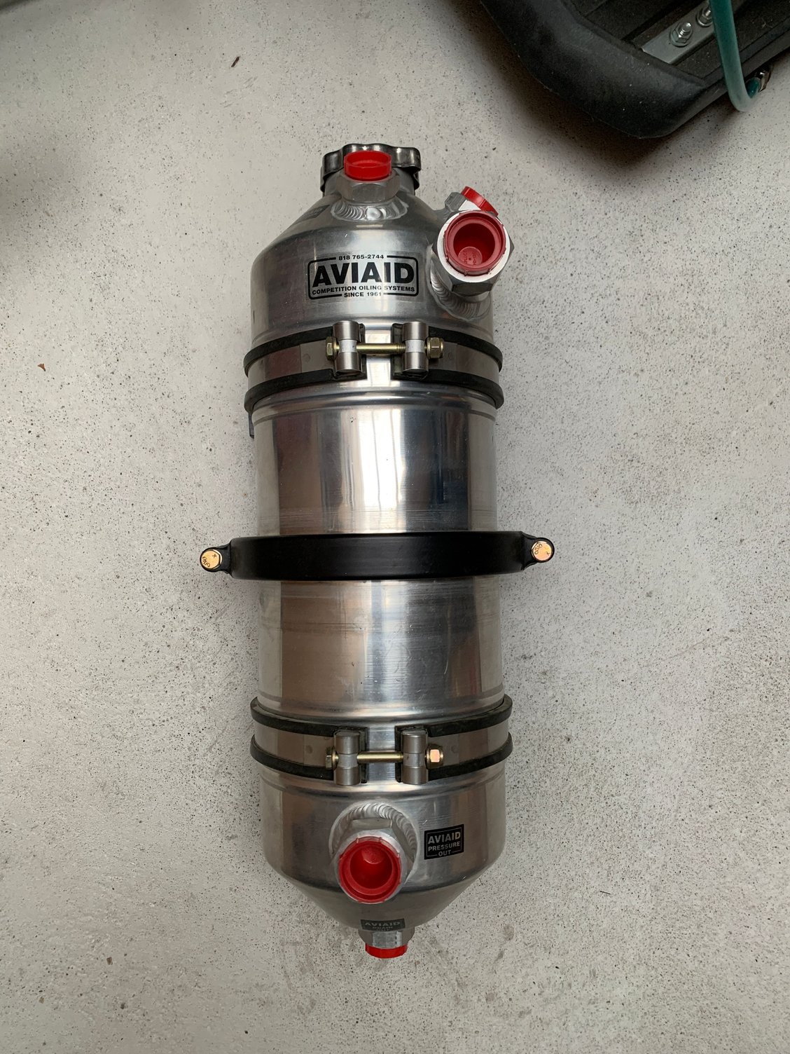

I do not run the original oil tank, got an AVIAID tank.
Need to get more infos on that, where to connect which hose, how to connect to oil cooler.... puhh
first I need to find out which tank I have....
https://aviaid.com/shopsite_sc/store...ump-tanks.html
