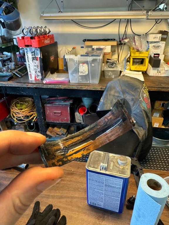

Spanks, the blackening on the bearing face is super heated oil. Can you post a pic of the cap? Is it blue from heat? For it to shrink, it must have gotten very hot. Here’s some thoughts…

The main cap did get extremely hot. Not as bad as I've seen in other pictures of actually spun bearings, but it did get hot as hell. There's maybe .050" of blackening on the main cap not quite up the side of it, but the chamfered edge just above the bearing. The biggest fear was if the block got hurt, but we should be good with just a new cap and align hone.

#4 main looked ugly underneath. It walked around a ton.
