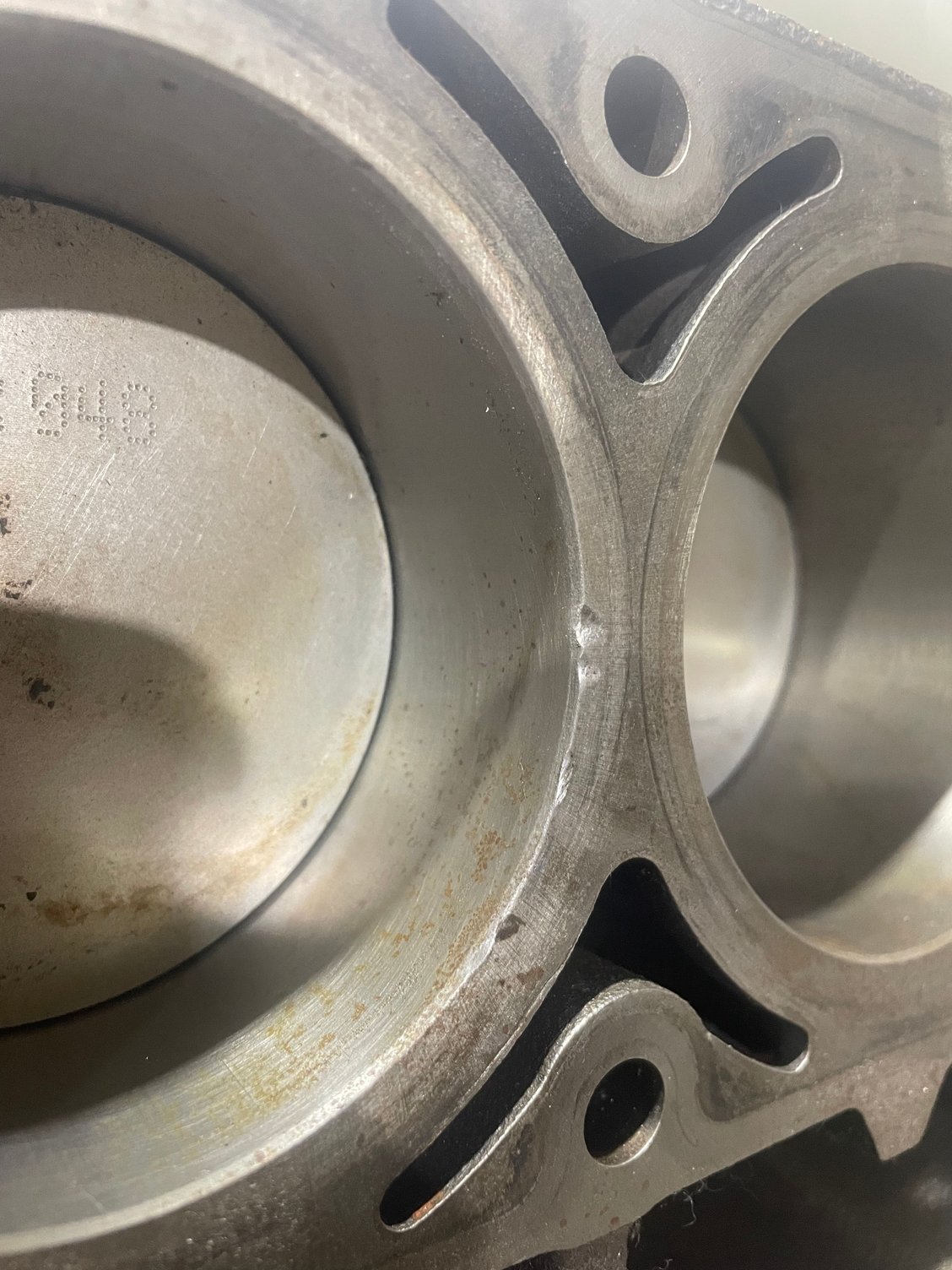

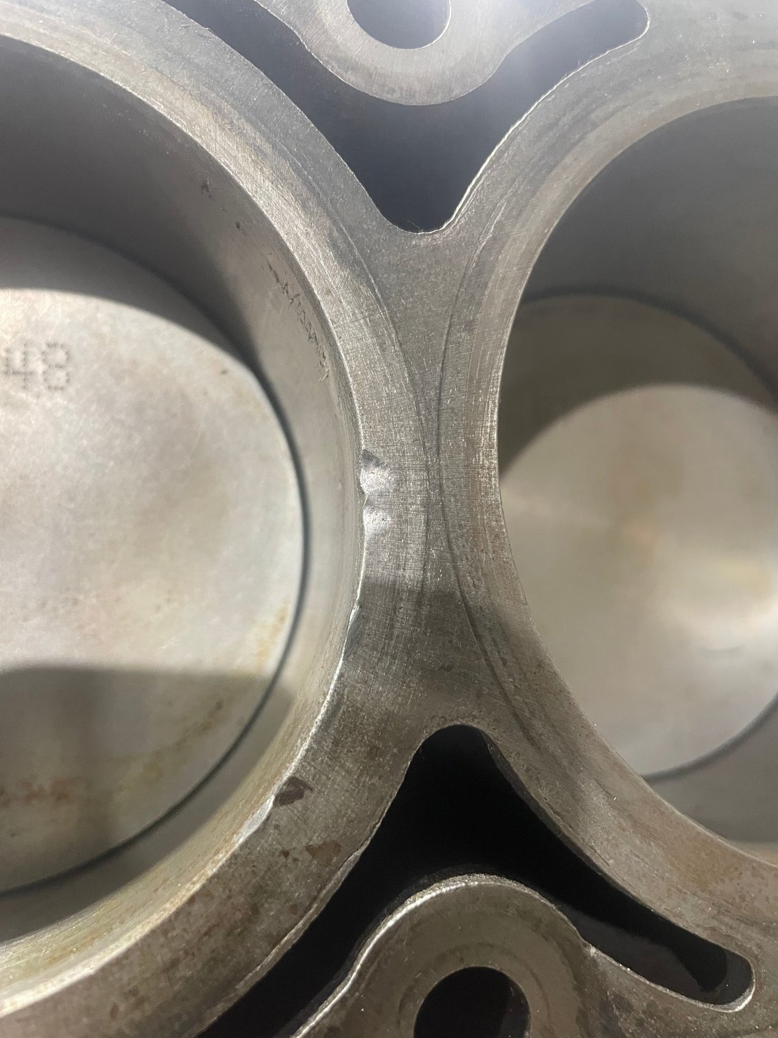

Building gen 4 with Tsp heads and cam ,ls6 intake, looking to possibly boost (8-10 lb) later down the road. Ordered all my parts and got ready to start building came across these gouges along one cylinder, what are my options for repair can a machine shop fix it, will it have to be decked? Any thoughts never had a motor need machining so I’m not even sure how “bad” this is.
any feedback would be much appreciated!

A good machine shop can fix it and it might be a good time to go bigger on the bore.

That's an ugly dent. Did that block come from Hialeah, FL lol(Google it for a laugh)? From the looks of it, it's inside the fire ring on the head gasket, but I would deck it till not there for sure. Down side is it looks deep 005+. Only way to know is to do it. The bore has issues too. I'm guessing that's a 5.3 block from the pics. If it were me, I would yank the rods/ pistons out of it and get a 6.0 block. More/less same $$$ to build. Building a 5 3 is a waste unless it's skyhigh boost and you need the cyl wall, or you are lazy and already have it.
