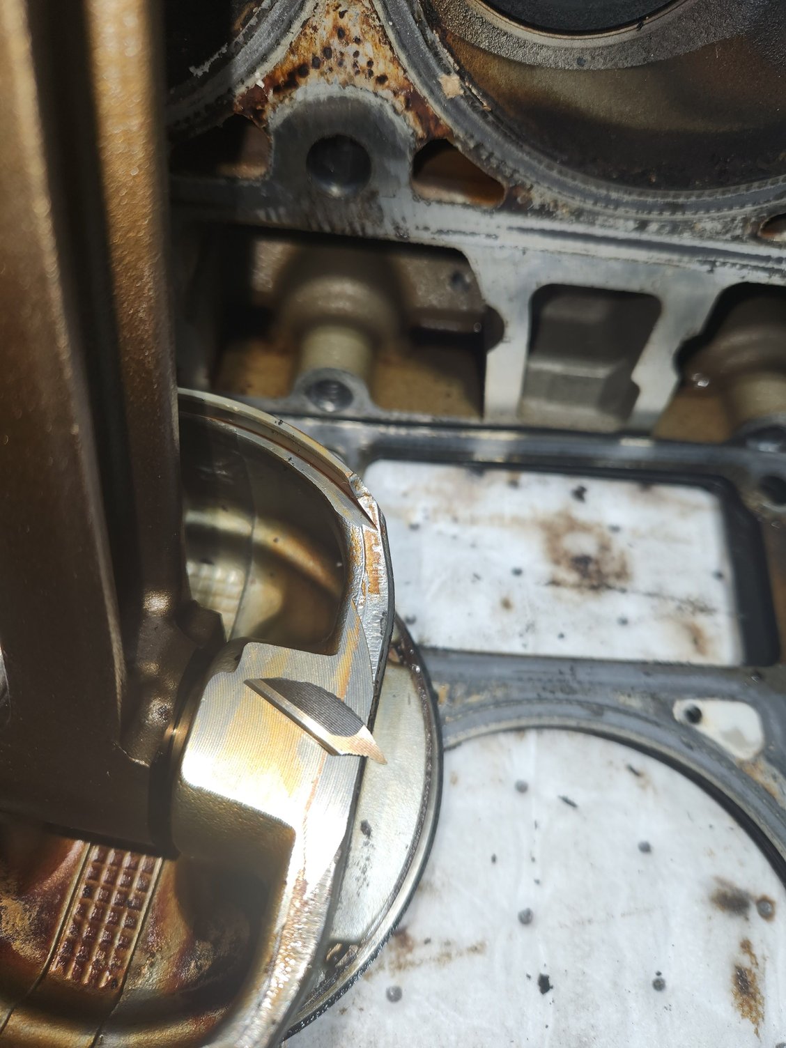

The mystery deepens! I've got all the pistons out now and cannot find a missing piece anywhere.
I now believe that the piece was in the pan from another motor, the pan was off when I picked the motor up.
I thought it was from number 1 because that one is a little different looking than the rest.
Here is a pic of the piece and where I thought it was from. It's too big to be from there.
So that piston on your first post that appeared chipped was an optical illusion or something? Looking at your photos, that chunk does look larger.
So everything was good then? Doh!
I guess since you already tore down the engine, you will have more confidence that ever is good.
I accidentally dropped a piston/rod when I was pushing the pistons out of the bore (learned I need to be more careful!) I had a bit of mushrooming on the edge, which I filed down flush and it didn't get close to ring land, so I sent it. It was just a stock rebuild in my suburban 2500 daily driver. It's been running good.
Yep. looks like it. That one piston just looked worse than the rest.
