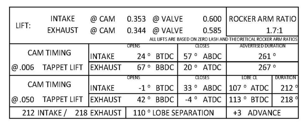

Those are very high numbers what compression are you shooting for? If you are say at 11 to 1 you might want to confirm your valve closing events. Pup gas I think is around 210 or so max cranking compression. YOu have pretty short duration cam in here or what is the cam you are running?

Yes the build was supposed to be around 11:1 CR and the cam is the Summit Big Truck Torkinator 212/218 .600 int./.585 ehx. lift. I CC'd the heads as accurately as I could with a 100cc syringe and a piece of plexiglassa and came up with 65 so I calculated it to be at 64cc chamber size just to be safe. The valves were lapped and leak checked with gasoline :-) Im not opposed to taking the heads off and putting thicker gaskets on it to be safe or am i going to have to get new heads... Learning lesson test **** before getting it milled lol.

I think the issue is the cam. That cam was designed to build max low end cyl pressure in a 4.8-6.0 w/ 10.0:1 compression and you are pushing that in a 11:1 408. I think that cam is small in a stock 6.0, much less a stroker build. Double06 is right, pump gas is out with that type of cranking comp. I would re-cam it. I don't think dropping the compression with a gasket is going to be enough to make the combo work.

If the lobes are symmetrical, then the .006 cam numbers put your dynamic compression ratio at 9.22:1.
I think I did that right.
If I recall, 8.7-8.8 is about peak for pump gas.

What is this going in with a 200 or so at .050 that is like for a tow truck or something like that? If this is in a car and you want some performance you want like in the 220s duration at .050 and that will bleed down the cylinders. For more all out performance a cam in the 230s at .050 is more in line but you begin to loose some street manners.

Not sure what the intended use for this engine is but that is a tiny cam for a 408. Being in TX you should be able to get 93 octane everywhere which will support 12:1 compression.

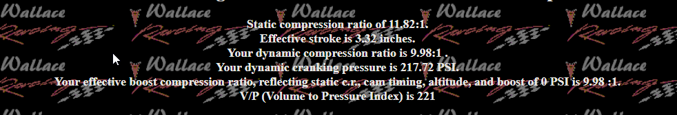

So the oil looked pretty clean compared to the first change and the compression test came out to 220-225psi. The calculators I used are suggesting my calculations are off somewhere so I even over estimated the deck clearance at -.020 and the chamber size at 68cc to give a 10.82 SCR. That combined with the wallace racing DCR calculator at 57° degrees IVC gives the motor an estimated 9.98 DCR??? Did I do that correctly? Sounds like more head gasket thickness or a bigger cam is needed or I am right at the fine line of don't let the IAT's spike or get a bad batch of fuel?
Also why does this calculator give an effective stroke smaller than 4"? Wouldn't the rod be parallel with the furthest reach of the crank at BDC and
TDC or is LS geometry wonky?

I think your deck clearance is off. The negative sign is ok, but I'm sure it's not -.020". The most I have seen above deck is about .006". If the piston is below deck, use a positive number.

When trying to make sense of the high compression numbers compared to my calculated DCR I overshot the negative deck clearance further above deck so it would make sense on paper. I do think the the actual deck clearance was closer to -.006-.010
